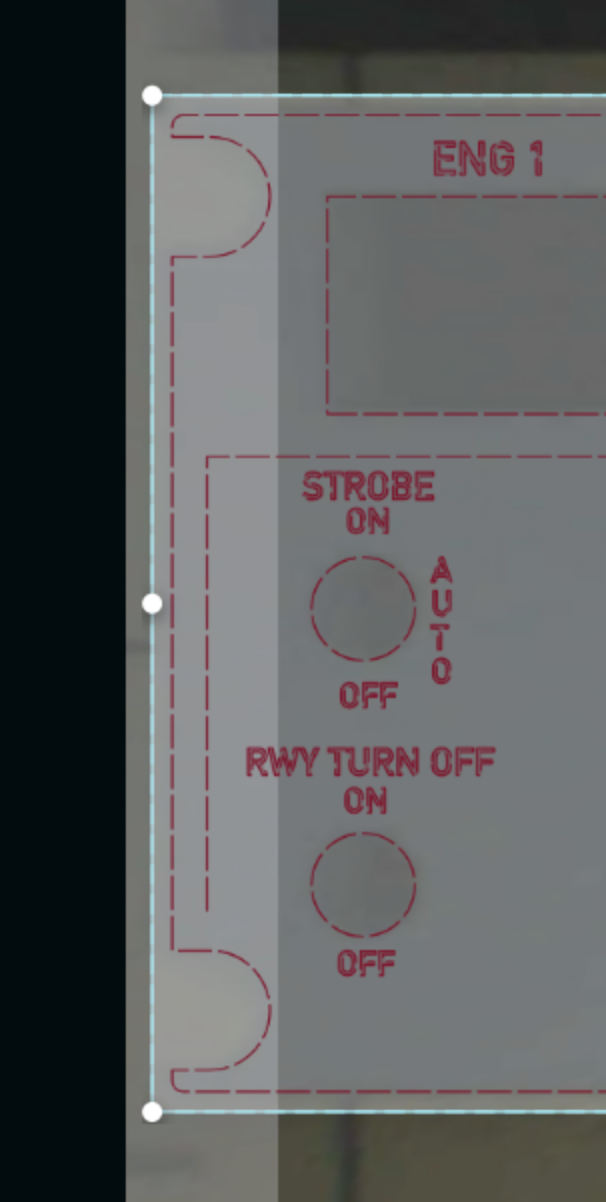

OK, I have done A LOT of GF jobs over the years, for this project I had a weird issue crop up and I can’t ever remember this weird problem. So I cut a panel in acrylic, then did the painting and when I put the painted panel back in the hole I cut it out of (the acrylic panel didn’t move as I had the panel taped in place with gaffer’s tape) the job was now outside the printable area, which is really odd as I had cut that exact position a few hours prior without moving it…
That’s strange! Did the settings change at all?
In theory no, I went back to the same job and changed the engrave layer from ignore back to my custom engrave…
Adding the Engrave COULD mean a speed change, and head speed can change the available work area, due to ramp-up/slowdown…
yeah but it was in the same position as it was when a cut was done. Cut will always be faster than engrave. That doesn’t seem logical to me.
And weirdly I turned everything off and enabled the original cut profile, same result…
I can’t tell from the photo if the material and therefore the engrave elements are near the border of the usable part of the bed. Engraves near the edge will become outside the engraveable area if the speed is high because of the distance needed for acceleration/decceleration of the print head. It looks like one text line is the problem. (RWY Turn Off)
So how would engrave be faster than cut, when it was fine when it was cutting?
If the engrave was not enabled when the cut was done, the border issue would not arise. Once the engrave was enabled, the one line of text becomes outside the margin at engrave speeds which are usually over 500. The printhead needs room to speed up and slow down for each line of engraving and thus the usable bed area shrinks as speed increases. If the RW in that one line of test is moved over, all of the text would engrave.
Agreed. The most simple test is to “Ignore” all engraves.
Oh yeah, that makes sense. Funny that in all these years never ran into this before. I am using a very fast engrave since my goal is in fact not to engrave the acrylic, just the paint layer revealing the acrylic, so I think my tried and true is 1000/40 (yeah settings, I’m going with the setting is the specific issue here). The second op on that job is scoring so presumably not wider than cutting (although that is also in much closer to the inside of the part)
OOOOH, you also just solved a mystery, having at this point made like 8 of these that have been wrong for various reasons, I remember there was one that in fact was missing the R, and I was perplexed as to why out of the entire sheet only 1 letter was not engraved despite seeing it in the GFUI, but now it makes total sense.
