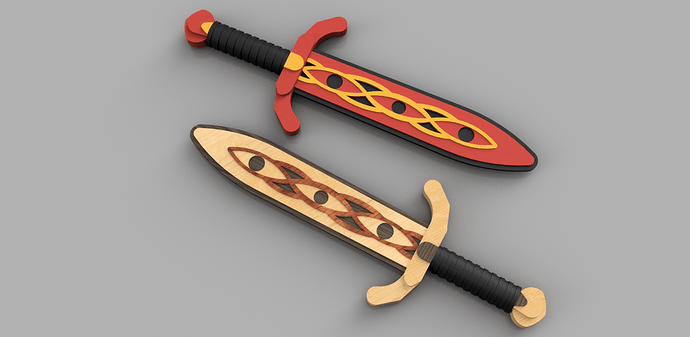

Toy Sword
Here’s a toy sword. I intend to eventually cut it out of foam once my GF arrives, but you could also make it out of wood.
It’s not as elaborate as some cosplay swords I’ve seen, but I wanted something “toyish” for the kids (plus I did not want to spend hours and hours on the design).
oneEigth.pdf (2.8 KB)
oneSixteenth.pdf (3.5 KB)
oneQuarter.pdf (4.6 KB)
There is one pdf per material thickness (1/4, 1/8 and 1/16 of an inch). The 1/16" could be done in 1/8" as well if you can’t find 1/16" material.
If you want to use different colors, you’ll have to decide which parts of each pdf to include in which color. I think it’s pretty straight forward which part is which in the design. If you have any questions, let me know.
The sword is only about 23" long, so it’s pretty short. But I wanted to be able to cut it on the GF without the pass-through feature. That’s pretty much the limit of a one piece sword. I could split the main piece in two, to make it longer. I’ll probably try that in a later design.
I don’t take any responsibility for any of your kids (or adults) that hit each other over the head!

Those are great! Is it just me, or does the red, black and orange make anyone else thing of the Eye of Sauron?

how do you intend to do the handle? i find the roundness of that a bit intimidating to pull off.
If you look at the svg file, you’ll see the handle is made up of a stack of round parts. They alternate between larger and smaller pieces to give it texture.
Ahhh ok. i see that now. I thought those were handle pieces but it didnt make sense in my brain… i see it now… the one set of circles is smaller and the other is larger… having them separated made that less obvious – very subtle, but adds a great look/detail. thanks again!
Another way to tackle it is to purchase an oval dowel (or get an oversized round one and lots of sanding to get the shape you want). Then you can wrap it in leather cording all the way up. Tuck in the loose end and CA glue, and you are all set (this method will result in less pinching if you don’t get the alternating circles tight enough.
