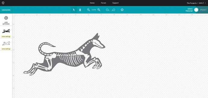

Actually, I think I located the source of the problem. It’s in the jaw of the skull, and how it relates to the skin outline. It has two paths and some strange compounding going on. Pulling it apart, you can see how the jaw isn’t really just a solid body, it’s actually a compound of solid+trace with some messy points in between.
For example, after digging into the shape and moving points around, this is kind of a blown-up mutilated sample:

The twisted paths are unfortunately symptomatic of auto-trace. I assume this was auto-traced? Not a big deal when viewing on-screen, or even sending to a desktop printer. But, apparently bad juju with the GF and it’s RIP software?

Okay, let me look at this new one…it’s going to take some different things…it now looks like the image @Drea posted. There are some orphan paths overlaying the base, which will cause problems, but other than black fill in some of the overlays, instead of white, I haven’t had a chance to dissect it yet.

Okay…last one - This one will work, and I think the problems were created by trying to do a subtraction on a group.

Okay I had to:
Zoom way in while in Outline mode and remove the orphan paths. They were overlaying the other path and there were three of them…the only way I know to spot them is to zoom in and look for thicker lines.
Release the compound path. Some parts of it were filled with black.
Ungroup everything.
Put white fill into all of the parts…then…
Put black fill into the outer path. (The one on the bottom.)
Lock the eye. (It needs to be on top of the other group and treated as a separate engrave.)
Select everything else, the white parts on top of the black background shape, and do a subtraction.
Then unlock the eye and give it a black fill.
Group everything.
It took longer to type it up than it did to do it, so it shouldn’t take long to fix the other one. Just release the compound paths and ungroup everything before doing the subtractions - I think that might have been the issue.

That’s because you don’t have an interface yet to test it on - this is what the one you loaded looks like in the interface:
The jaw was not causing the problem with the ribs, which were caused by trying to subtract while grouped.
Between all of us, we managed to get the problem licked, which was caused by multiple issues. @jbmanning5 and @mpipes found the orphan nodes and path intersections, you fixed the jaw, and I’m going to credit @dan for the group problem with the subtraction.

It’s not irritating at all, it’s just the way that Illustrator works. You have to subtract out any areas that you don’t want engraved, and those were not subtracted out. If you open the file in Illustrator it shows those areas as having black fill. So the GFUI was showing exactly what it saw.
It’s an Illustrator issue, not an issue with the Glowforge UI. :slightly_smiling_face:
Well that’s still kind of strange, because subtracting the white of the ribs and tailbones is exactly what I did on my version. But you’re saying that my version also shows those bones filled with black, from the screenshot you included.
So if you imported my version directly into the GFUI, then it still leads me to believe it’s something odd with the GFUI and/or Affinity Designer. But both Inkscape and Affinity seem to be okay with it.
