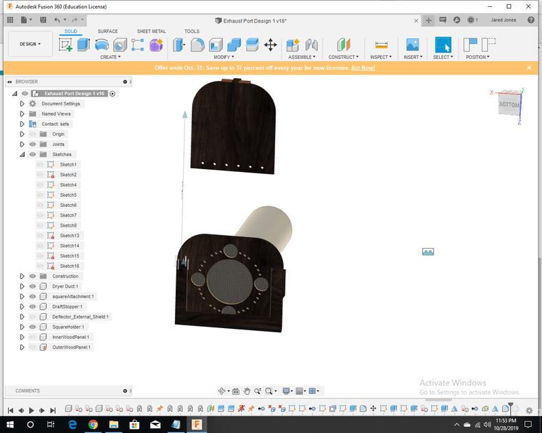

Window Exhaust Port Made on GF
This is fully modeled, but I have yet to receive GF yet in the mail so the design is not currently implemented in the physical world. Constructive criticism is welcome and appreciated.
This is an exhaust port designed to vent fumes out a window from the GF through the included dryer ventilation hose. The finished product will sit inside the window sill and allow the fumes to easily pass into my backyard. All parts are designed to be laser cut or are easily purchased from Amazon.
I’ve taken suggestions written in comments for similar projects and incorporated them into this the best I could. For instance, I’ve included a sliding draft blocker to stop backdraft when the GF is not in use. I’ve used neodymium magnets to make coupling/ decoupling a simple process.
I’m considering adding an internal fan when I get around to the second version. When I add it, I’ll also make sure that the fan plugs into the wall and is smart/ arduino controlled.
I based this design of the exhaust port in:
View a 3D version at:
https://a360.co/2MSzwjJ
(it can also be downloaded there to be used with fusion 360)
I know this is old news. Others have been making these ports and releasing their designs on this community forum for several years now. What I’ve done is only a slight variation on the old, nothing new. I’m new to the community though and thought I’d post my 2 cents anyway.
That being said, I’m very satisfied with the design.
Step 1: Created the base sketch based on the size of the duct, the width of the window, and placement of the magnets,
Just a simple sketch. I made sure to keep track of useful parameters as I went.
I measured the width of the window (from the inside of the track) to be 34.75". Outside the track, the width was 36".

Step 2: Extruded basic parts
-2 window boards, inner and outer
-2 square attachment pieces, which fit together. An activated carbon filter fits between them. These will later be screwed together.
-1 draft blocker, a board that slides behind the square attachment to stop a slide down and block backdraft while the GF is not in use. It is fastened to the bottom by magnets. It also is suspended by magnets while the GF is in use. It needs to be held up so that air can flow beneath it.
I then added a handle on the draft blocker.
The square attachment slides into place and then is secured by wooden clips on the side and curved holders on the bottom. That way, the magnets don’t have to do all the work and even if the hose is jostled, the square attachment will at most shift and then snap back into place.

Step 4: I rotated the duct to wall connector to avoid the screw holes conflicting with the magnets
Step 5: I added activated carbon filters between the front and back square attachment blocks and along the edges of the slot for the draft blocker
Not much to say here. I just measured the thickness of the activated carbon filter I had to be close to 1/20" when not compressed, and assumed that a 20% compression should be sufficient (down to 2/50") to halt stray fumes from rising into my room.

That’s pretty impressive. Nice writeup.
Thanks! I’m super excited to be part of the GF community. I can’t wait till my GF arrives.
Very impressive work. Amazing detail and thinking things out. Your ability with Fusion will do you well in creating designs.
There are however a few points where the universe might slap you around a bit, as indeed it does to all of us. I had a number of designs that did not survive contact once I had the Glowforge. You might notice the many complaints about how fast the compact filter fills up that has a surface face of about 18 inches square and compare that area to the area inside a four inch circle. Even the grill of the exhaust port that is an array of about half inch hexagons is problem enough that it requires regular cleaning and its removal high on the list of modifications once the machine is out of warranty.
One of the first things I noticed when I got some one inch square by 1/8 neo-magnets was that they came with 1/8 inch plastic spacers and even then were hard to remove and if allowed to touch it took the intervention of a plastic knife to start to get them apart.
I think those are the biggest issues I have noticed that you might want to think about. There are others that folk here might notice but your attention to detail and ability with Fusion will serve you well as you discover such aspects of the universe that diverge from the ideal.

One thought with the sliding door–will it clear your window sash when you slide it up? Rotating it so it moves along the side may eliminate any interference with the sash, since the idea is you don’t ever need to move the sash to make this work, correct?
And include foam in your Bill of Materials–you’ll want a nice seal between the window frame & sash, and some foam insulation tape, or cut insulation pipe to ensure no exhaust gets blown back thru any gaps, as well as air leaks in general if you leave it in place… And be sure to put a nice weather proof finish on any wood you use in case this window ever gets rain on it!
Thanks so much! Yeah, I fully expect I might need a round or two of testing in person to hammer out the final details of the design. You raise an excellent point. The activated carbon filter here might only last a week (or two, optimistically?) And would need to be changed frequently. Therefore, I ought to make it easier to switch out the filters than it currently is- which requires unscrewing the square attachment plates. The good news is that sheets of activated carbon filters are very cheap and can be easily cut to shape on the GF so it won’t be a strain to replace them regularly.
As for the magnets, time will tell. If need be, I can simply lower the number of magnets in the design later. On other similar projects, everyone was worried that the arrangement of magnets might be too weak. I’m guilty of being an all or nothing kind of person.
