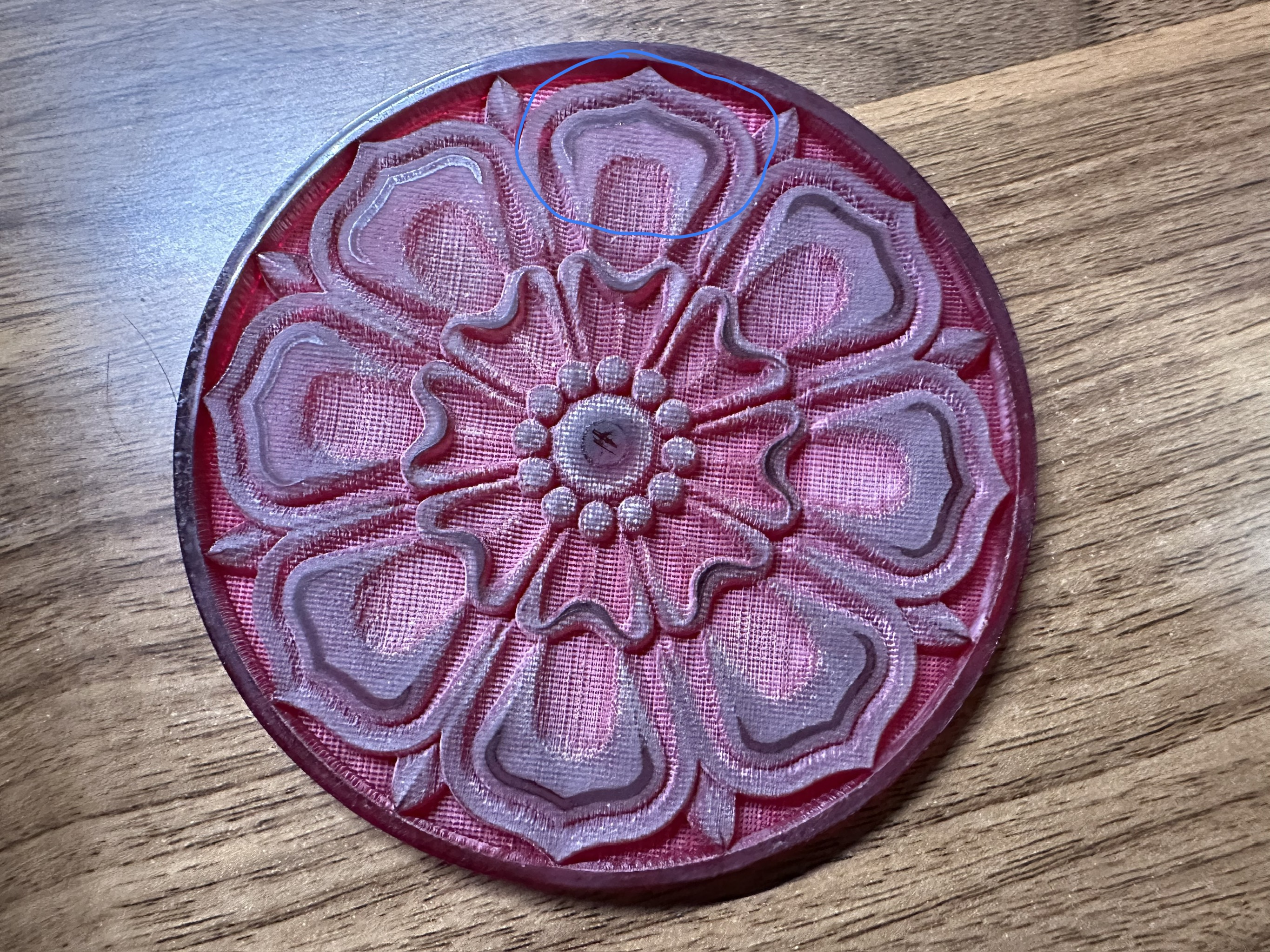

Here’s an example, as you can see, the engrave gave a relatively flat center of the flower compared to the lithopane (same dimension), the petals are also a lot flatter rather than having two obvious ridges.
I tried to create my own grayscale image using different % of grey as well and the engrave result was not nearly what it should be.
I have done a lot using just the center of that design.
What??? But your flower center actually looks well-rounded rather than mine is mostly flat. Are there any additional settings you change under the 3D deep engraving option?

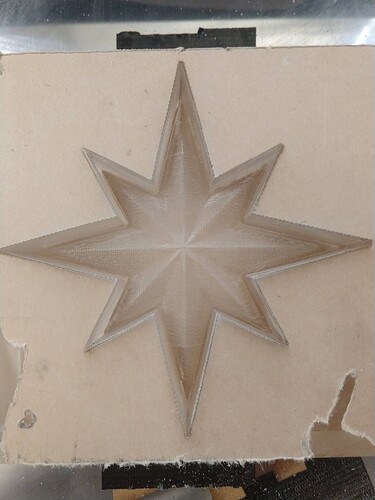

That last picture doesn’t look like a true depth/height map. The reflection on it shows a couple of light sources at the upper left and lower right. There wouldn’t be a shine like that on a depth map. Look at the star image @deirdrebeth posted, straight gradient from top to bottom, no reflection.

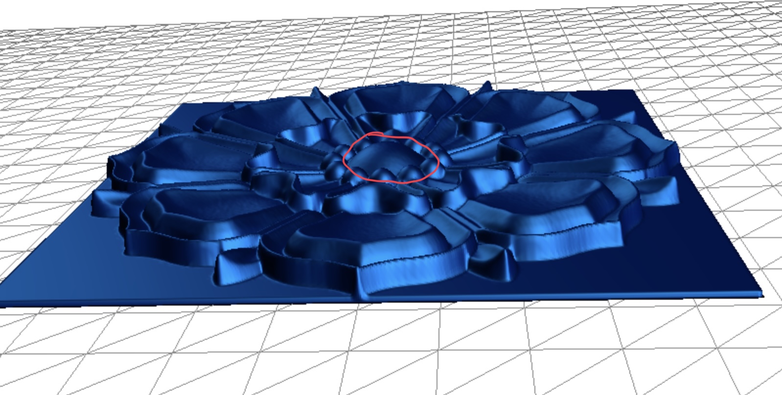

Yeah the blue model was the image to lithopane tool I used to get an idea of what the result should look like https://3dp.rocks/lithophane/

I did some color measurements on the image and the website scales grayscale linearly, unlike my laser for whatever reason

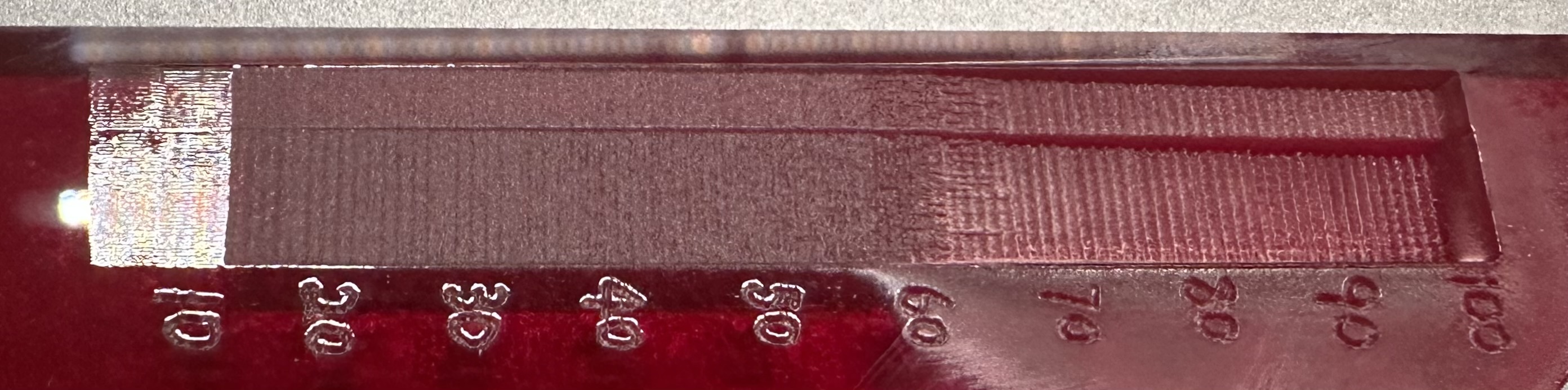

Thank you everyone for your replies, just to prove I’m not crazy, I drew different shades of gray, 5% difference in each line
And this is what default 3D deep engraving gave (I did not change any settings in default)
As you can see, it most definitely is not a linear relationship and depth increases significantly past 60% ish whereas 50% barely scratched the surface
I stopped during 2nd pass to showcase how more passes would only exacerbate the depth difference between different shades of gray, I would go through the entire material thickness before reaching actual 50% depth for 50% gray.

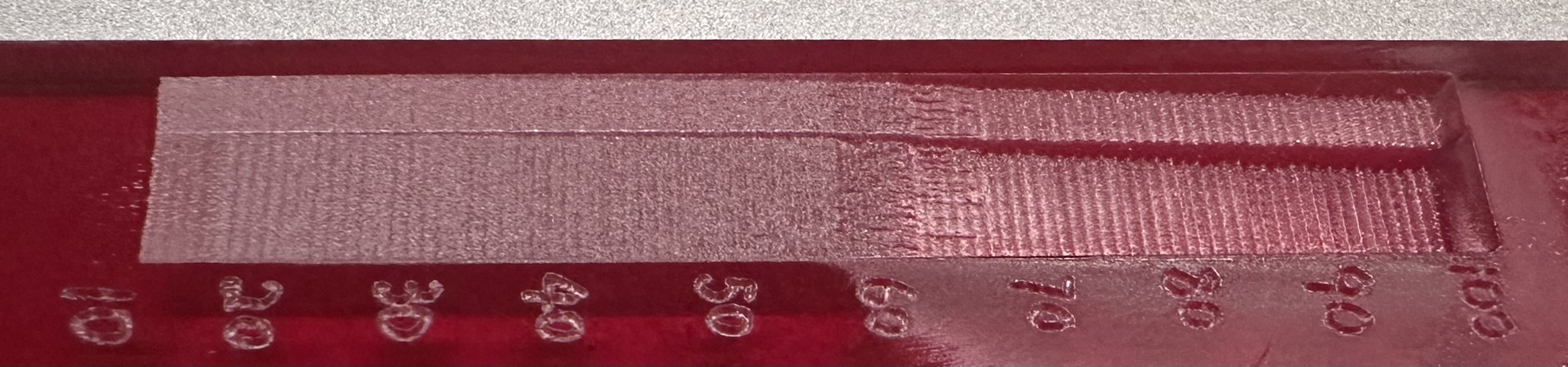

A better shot at the depth:
I made the input image using Procreate and saved it as JPEG then imported the image directly, unless this process somehow changed the grayscale, or Procreate, a professional drawing software, messed up their coloring scheme, I think this is the direct evidence that grayscale does not correlate linearly with 3D deep engraving depth.
I tried messing with the LPI and speed, it did not change this depth curve.
