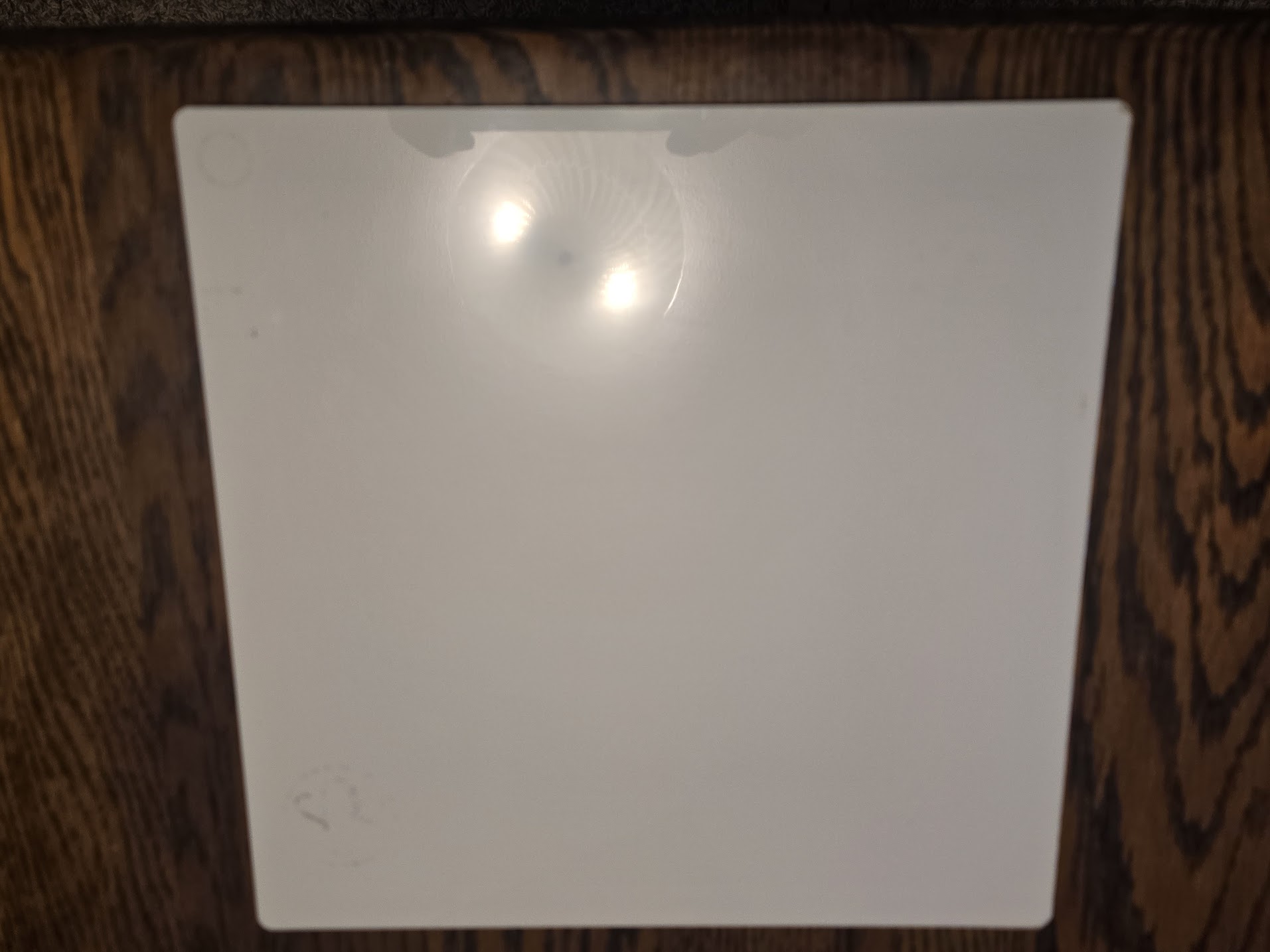

I have a GlowForge Plus and I am trying to cut Sublimation Hardboard MDF Wood Sheets 12" x 12",(3 mm) but have not been able to get completely thru the board. On the “Thick Draftboard” setting I get a faint line on the white side, but not enough to seperate the cut piece. I’ve used manual mode on full power with a less deep cut (no faint line) even with three passes.

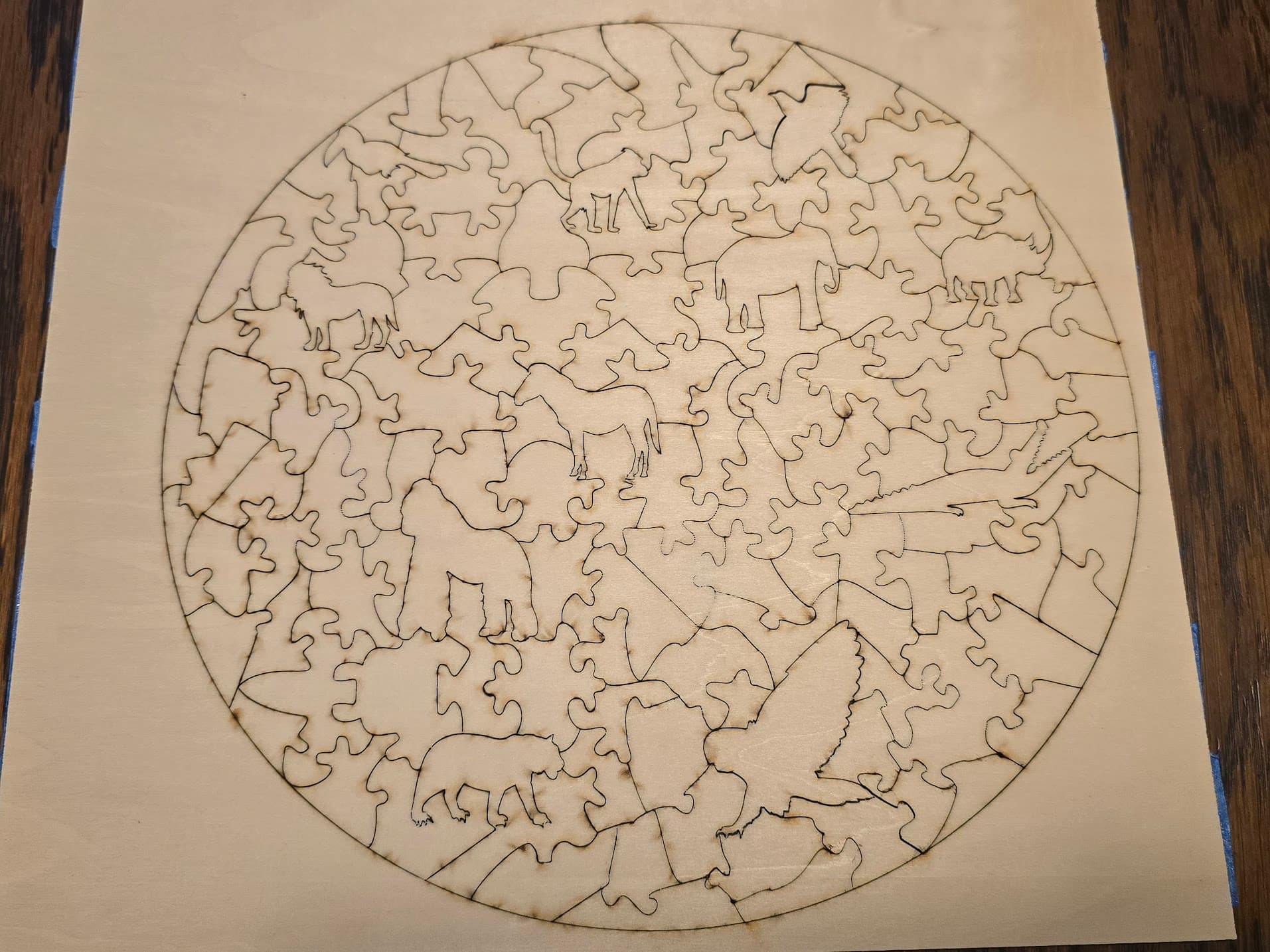

My first test to make sure the puzzle SVG worked cut just fine on medium basswood (see below).

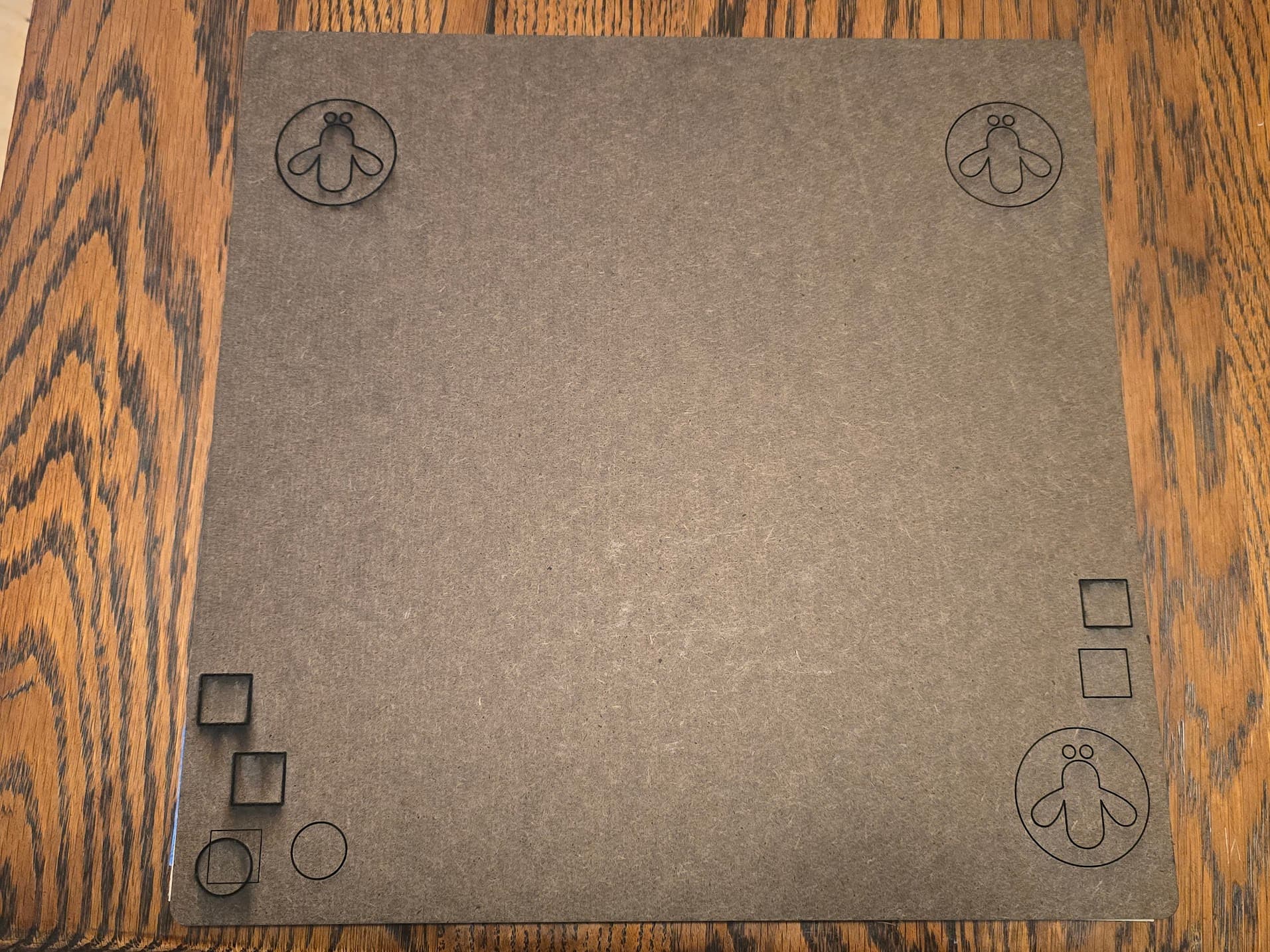

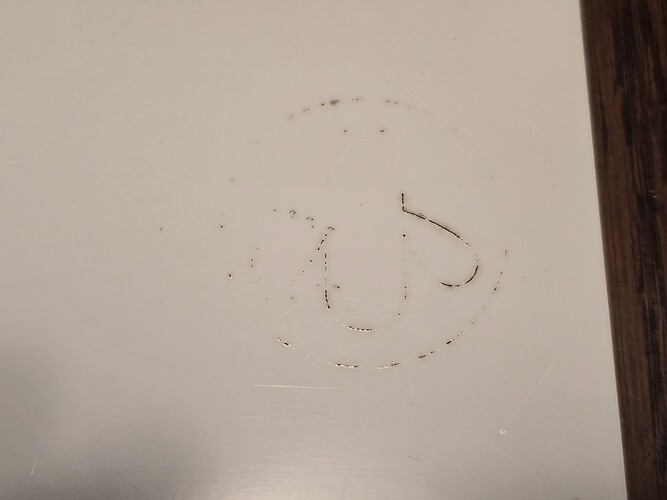

The tests with the MDF going thru a series of settings including full power/203/3 passes didn’t even show thru on the back. The only time I got a ghost line on the back was with the default Thick Draftboard setting. Pics attached.

It looks like the proofgrade is close. I’ll bet you can find a 2 pass combo that works well at full power. You just need to dial in the speed.
Try 130/full power and possibly 2 passes.
I suspect that will be far too much. Proofgrade thick proofgrade is likely135/full/1x ish. You’d be doubling that up, it will probably torch the back.
A two pass test ranging from 130-180/full 2x is probably going to cover it.
