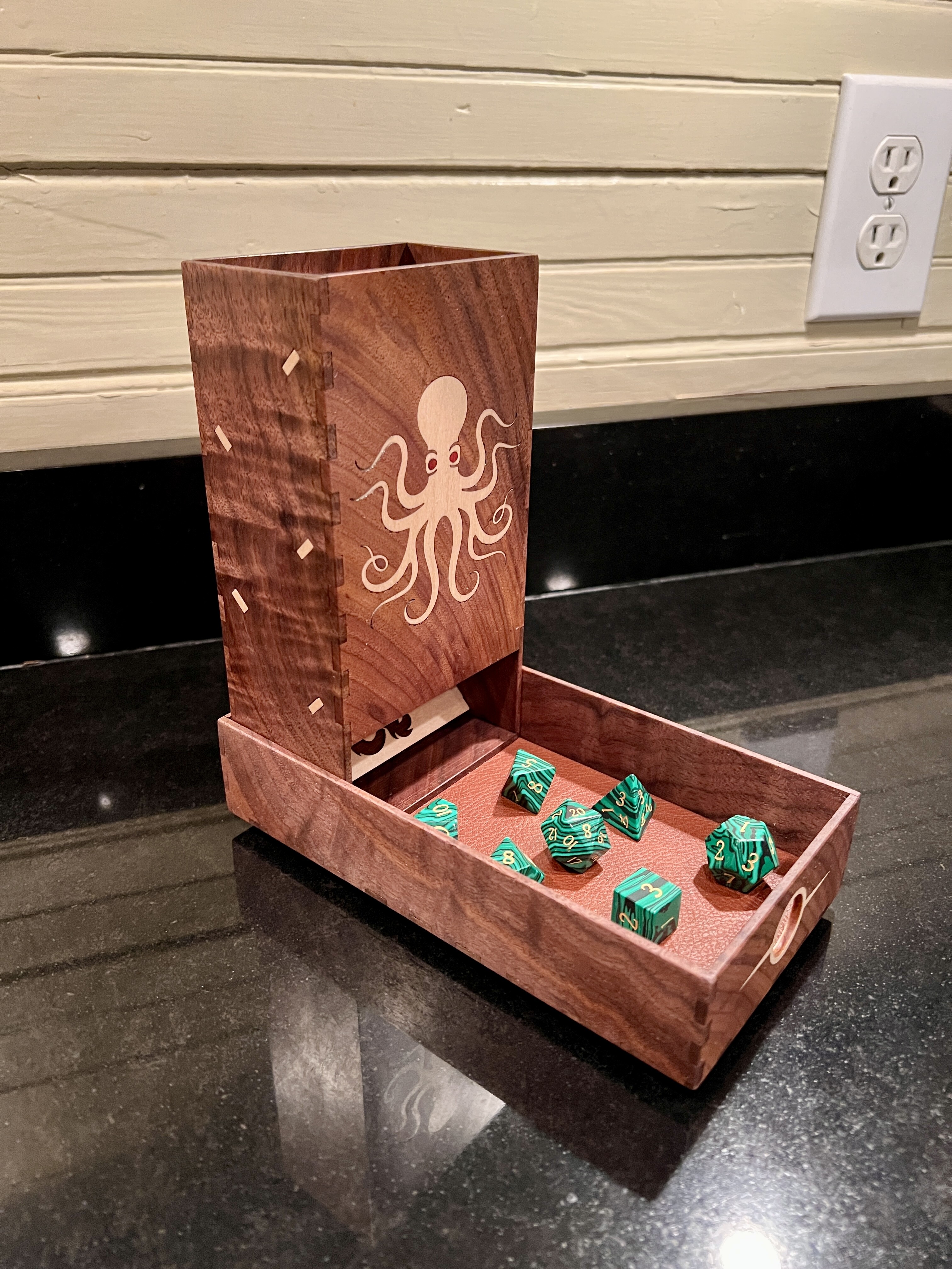

My nephew came to town for a few days and wanted to laser something. We spent a little time designing and thinking of ideas, and he landed on a nautical-themed dice tower. I should point out that while I may have provided some guidance, he did all the work here. Design choices, material choices, physical build, and finishing were all his work.
Figured walnut, maple, redheart, cow leather

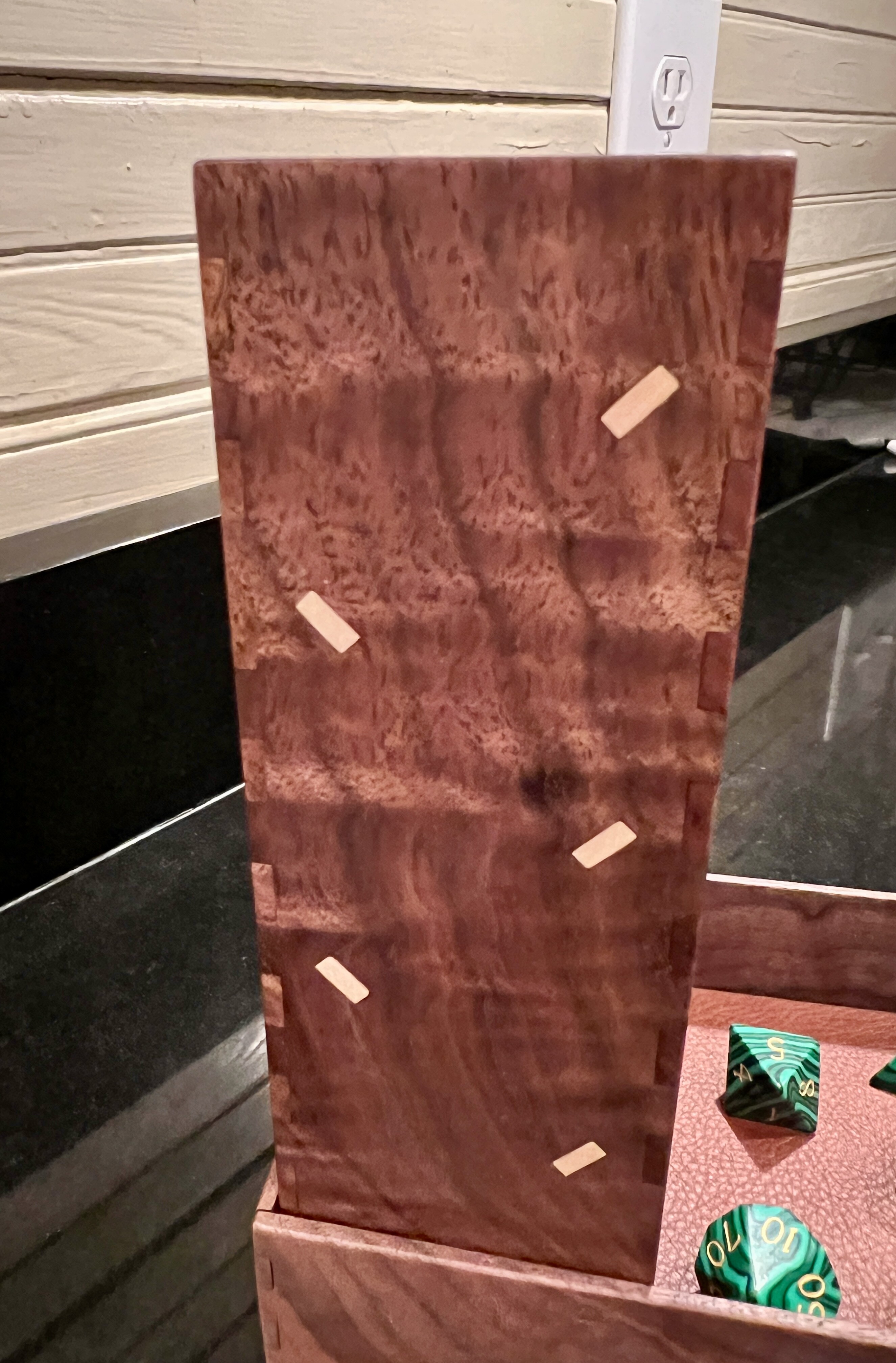

He chose to make the steps inside the tower out of maple to match the inlaid octopus and provide some visual interest to the sides.
Figured walnut, maple, cow leather

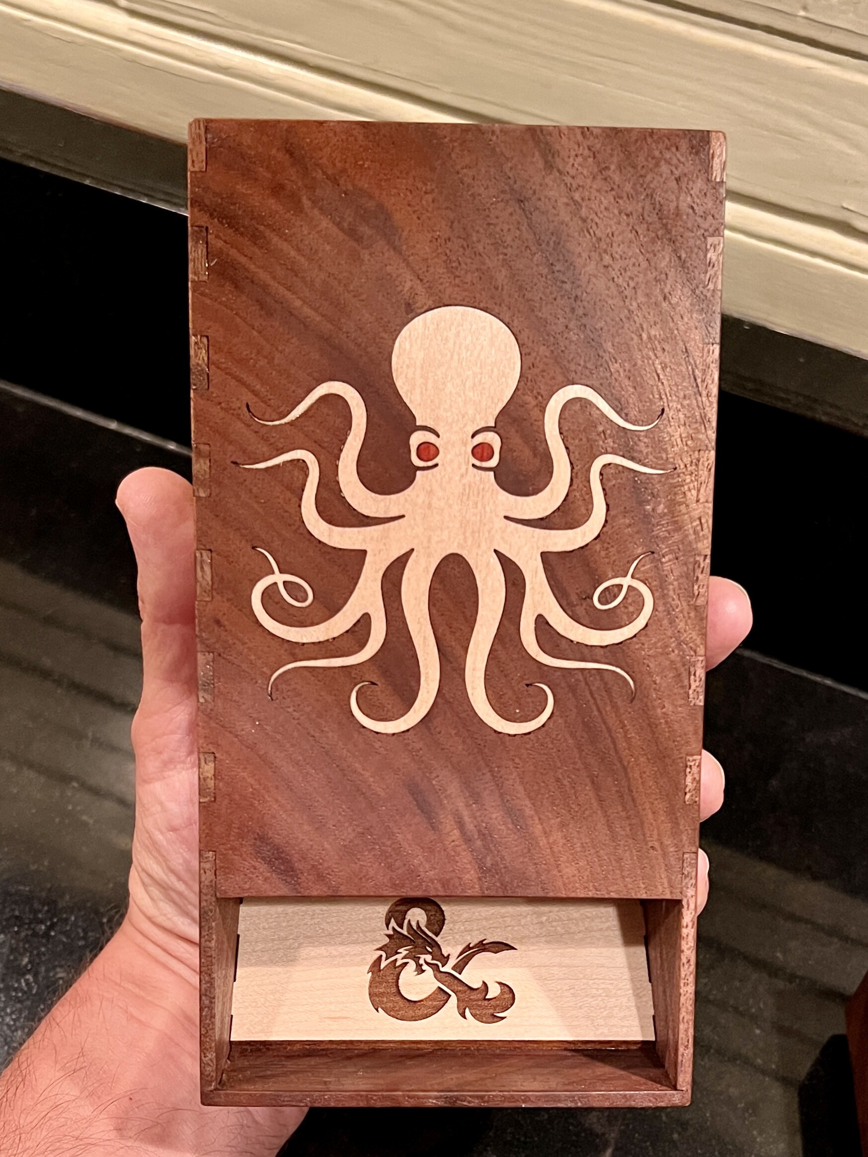

We found the octopus on vecteezy and then spent a fair amount of time optimizing it for inlay. He chose maple for the contrast to the walnut and then added redheart for a pop of color in the eyes. We added the Dungeons and Dragons logo as an engrave on the bottom “kicker” ramp as a fun detail. Fun fact: Redheart wood glows under a blacklight, one of the few woods I know that will do that.

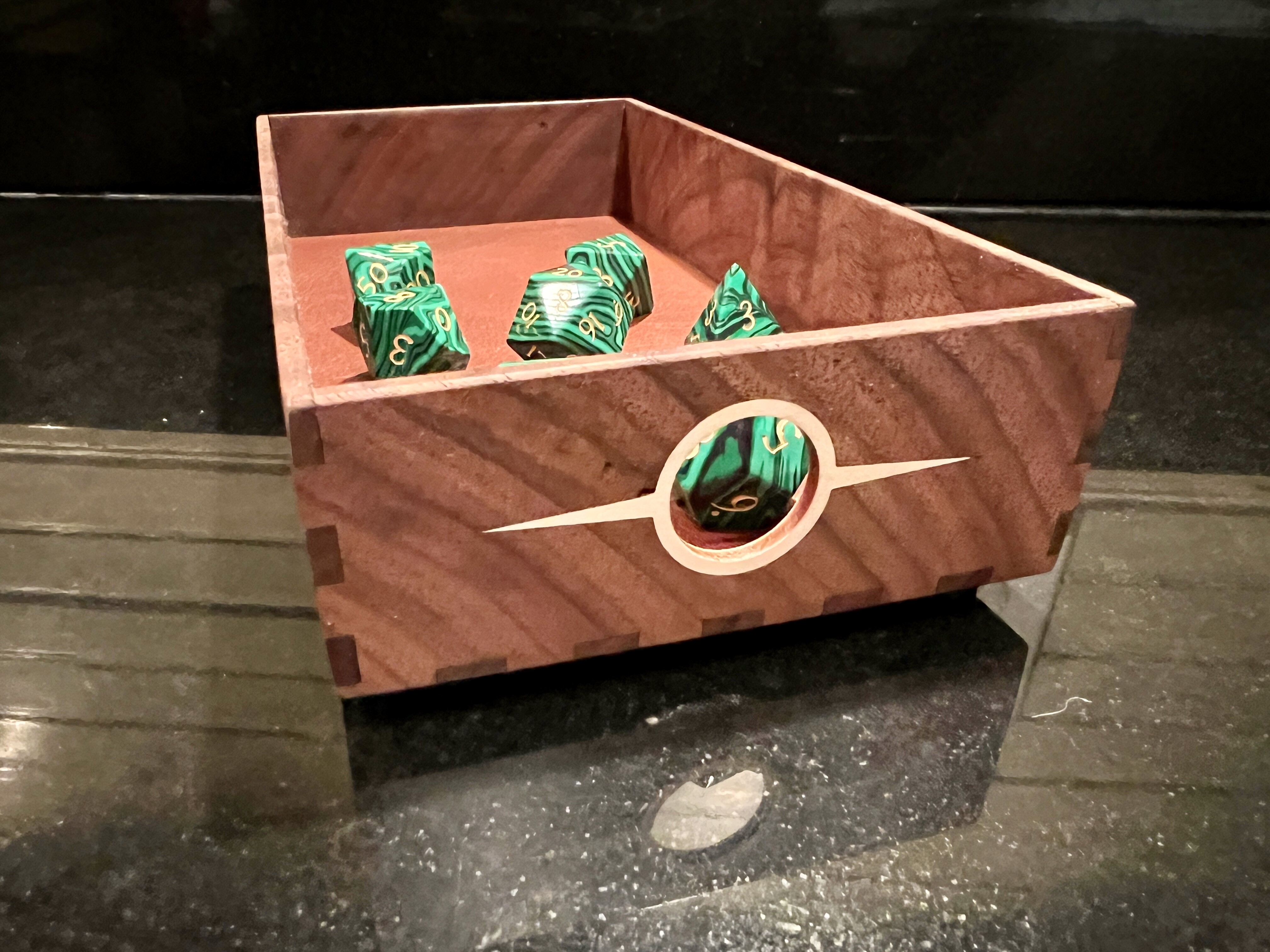

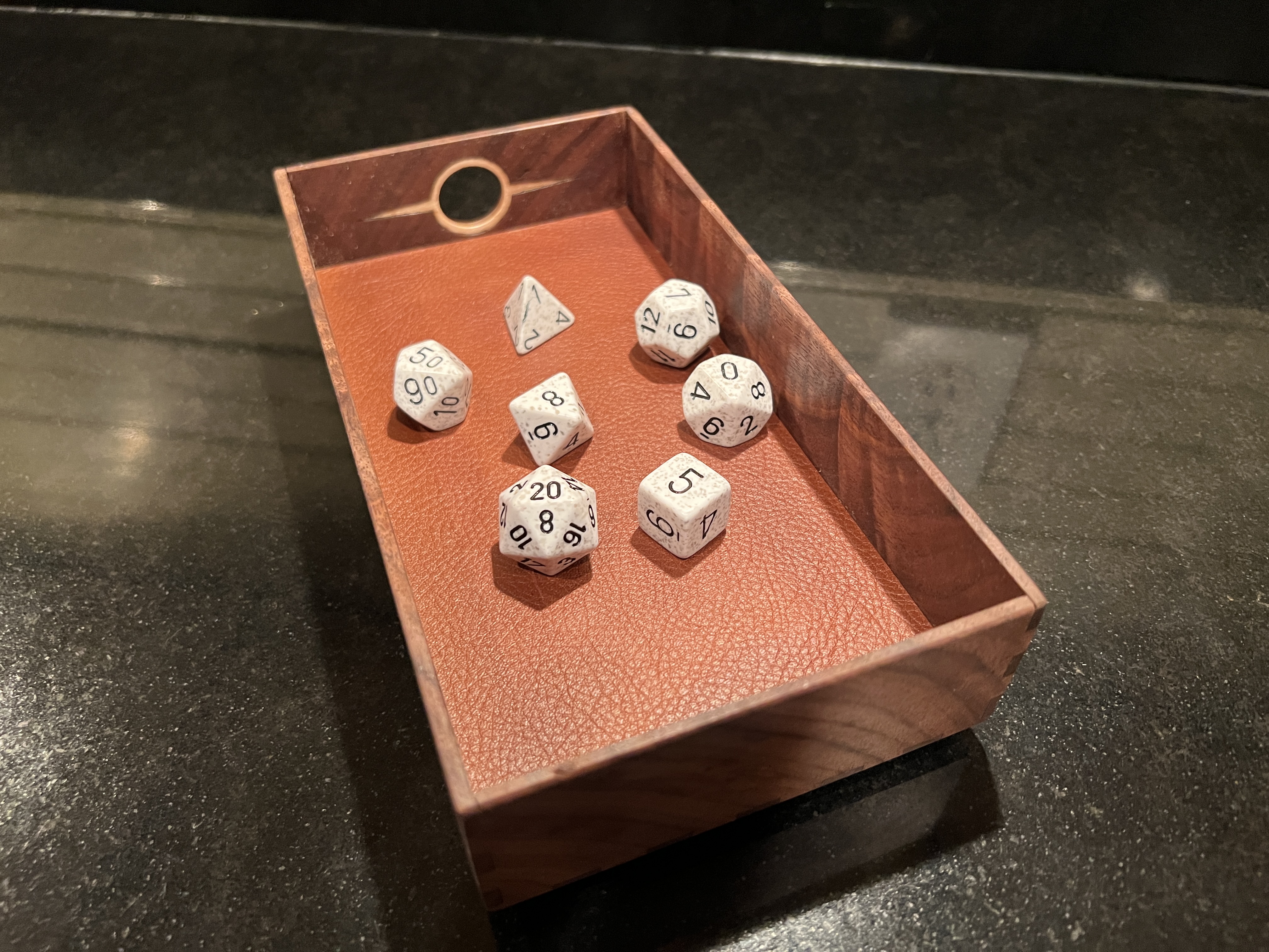

He’s a fan of an artist who has created a body of work called The Angelarium, so we landed on the symbol of the seraphim as an inlay/window in the front surface of the dice tray. I think this may be my favorite detail of the whole design.
Figured walnut, maple, cow leather. Bonus points for the malachite dice, they really look good againt the walnut.

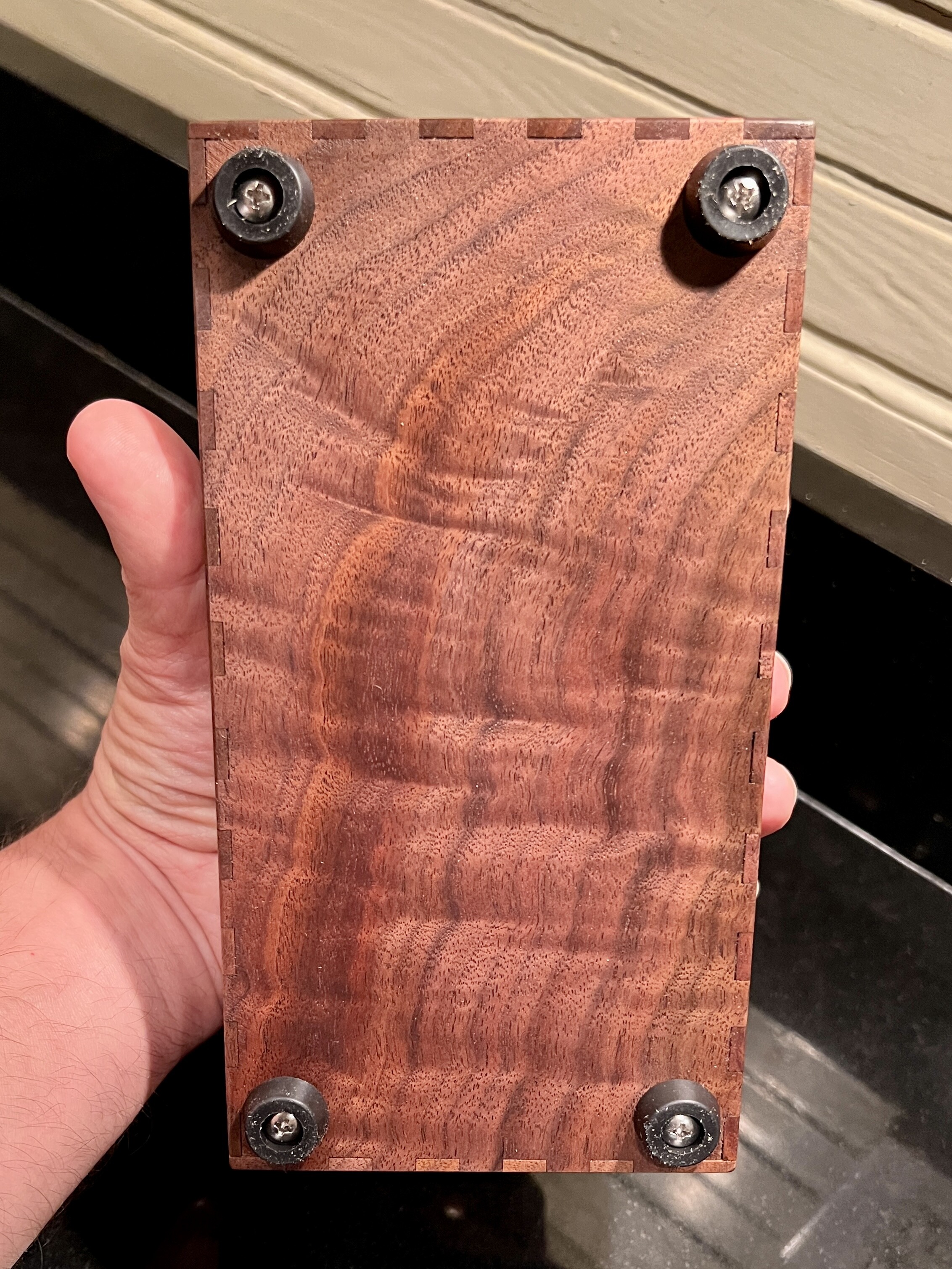

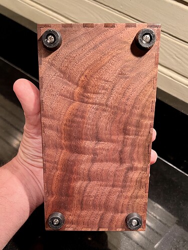

We used figured walnut throughout, even the bottom of the tray is just gorgeous.
Figured walnut, rubber feet, stainless steel screws
The seraphim symbol is a through-hole inlay, so you can see it from the inside as well. You can also get a good look at the leather he chose to line the tray.

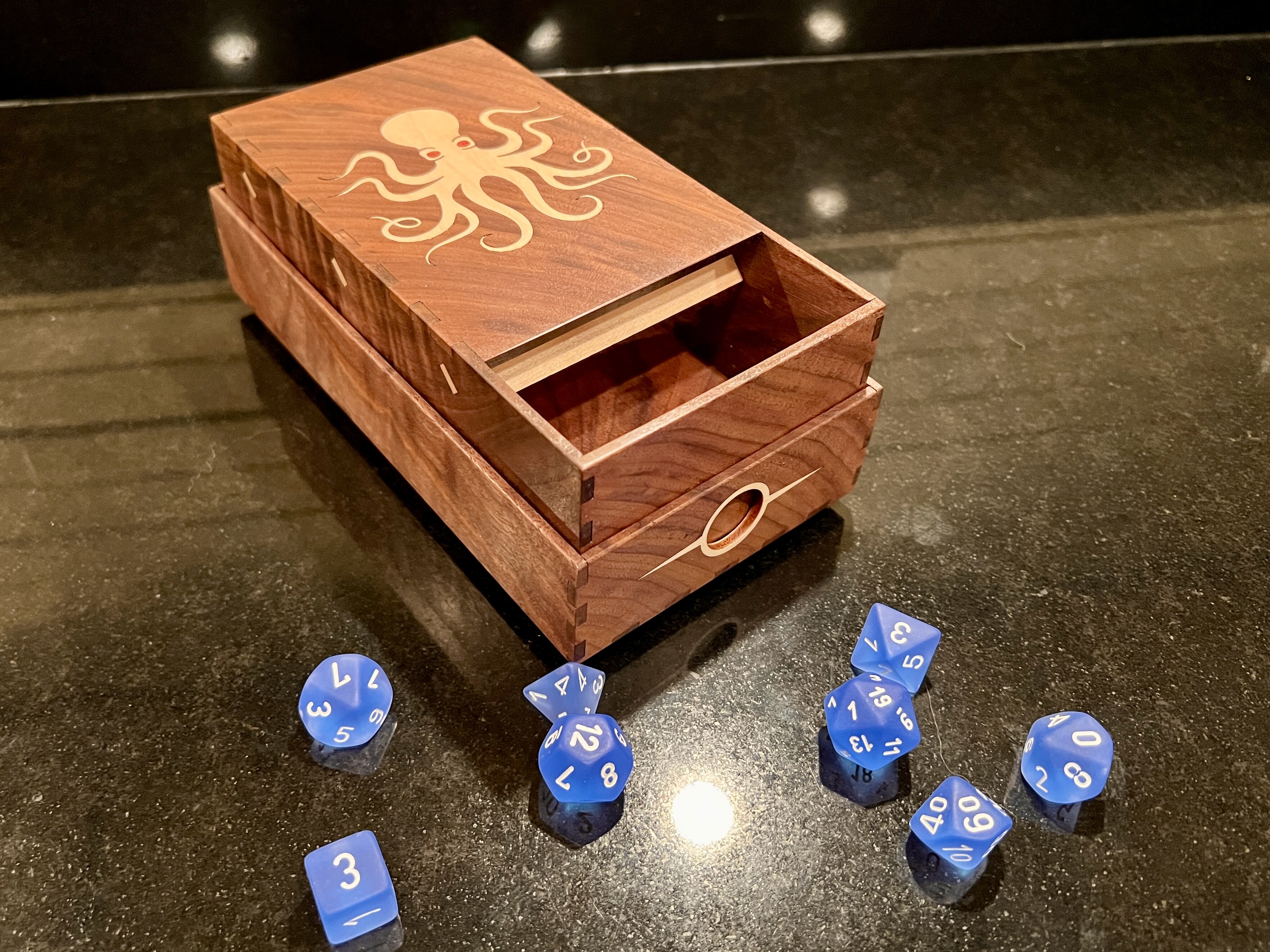

The tower is designed to nest into the tray for easy storage and transport.

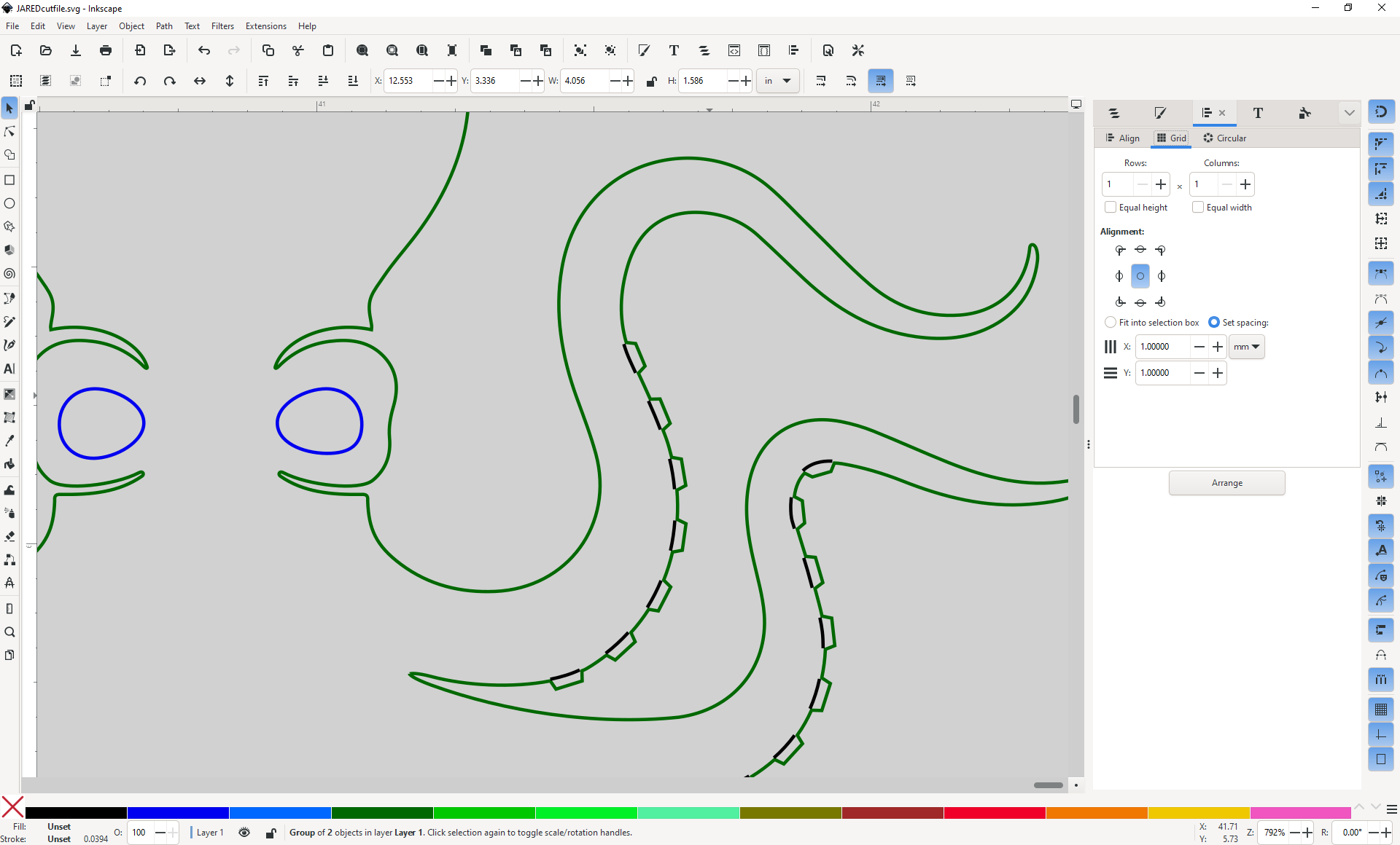

I’m curious about what had to be “optimized for inlay” in the octopus?
Yes, all Inkscape.*
* …except we used a box generator and imported it to Inkscape.
Yes Watco brand satin wipe-on polyurethane. My go-to, easy to apply and the satin finish makes a consistent surface with minimal effort.
Nothing too surprising if you’re familiar with through-hole inlay, and I know you are.
The original had some details that were too fine. The tips of the tentacles were really sharp and narrow, we gave them a slight radius. They’re still sharp, but they would have been overburned badly if we didn’t clean up the tips. We also used my overlapping paths extension to get some details for the suckers, check the black score lines:
The detail around the eyes needed to be adjusted to be thicker, they would have burnt to a cinder.
The eyes were smaller and more round, we enlarged and made them a little oblong to make the inlay process more clear and also just it’s a better look.
Lastly, there was kerf adjustment of 0.006". The design was symmetrical so we didn’t have to flip the design to be able to flip-mate it.
