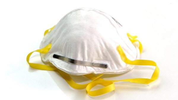

My understanding is that these are for surgical earloop masks.
N95s have straps that wrap around the head and are designed to be fitted without any clips needed.
Here’s a pic of the two masks. (the teal one is an N95 - model 1860) All N95’s have the around the neck/around the head strap.
Just curious. Could you ask her what snapped? What type of mask she was using? This would help with improvements.
This is not correct. Most of the N95 masks I have seen have earloops, but N95 refers to the filtration, not the mask style or how it secures to the head, so there can be N95 masks both with and without earloops.
The blue mask in your picture may rate as N95 by the effectiveness of its filter but it would not protect very well against an airborne virus such as Covid-19. I hope, for their sake, that healthcare workers have better masks. In addition to having earloops, the N95 masks I have seen are significantly larger.
All of the mask clips, including my next-generation designs and GF’s design, are intended for any masks with earloops, which would include most (but not all) surgical masks and many (perhaps most) N95 masks, and an unknown quantity of homemade masks.

Ear loop masks, no matter the material they are made of, cannot be true N95’s. They may market them that way, but they’re not rated n95 for medical use.
Medical professionals cannot use ear loop masks if they need a rated mask.
Being a paramedic, I find your statement regarding my 1860 N95 a bit odd. It’s a fit tested mask. Annual testing ensures we wear the right masks.
It’s 95% effective at 1 micron and gets better as the particles grow larger.
Where do you get your info?

Please pass this information on as ANY N95 with earloops is considered to be a counterfeit by the CDC. N95 is a rating that can only be attained through proper fit. Ear loops cannot do this.

From the FDA: “The ‘N95’ designation means that when subjected to careful testing, the respirator blocks at least 95 percent of very small (0.3 micron) test particles.” — again, N95 refers to the filtration, not the style. It’s 95% of 0.3 micron particles, not 1 micron particles, but Covid-19 is approximately 0.125 microns, so even an N95 mask is not perfect protection.
Your 1860 is a fitted mask; it didn’t look like one when I looked at the photo (it looks almost like the crappy painter’s masks I have). It’s also disposable, not cleanable, so that is a downside to masks like that and one reason for the shortage. I hope it fits well without gaps. Your work as a paramedic is appreciated — always has been, even if people don’t say it all the time — we all want you to be as safe as possible!
I have not found confirmation of your statement that no ear loop mask can be an N95 mask. You might be right, but neither the FDA or CDC web sites confirm. If it has to do with fit and tightness, perhaps an ear loop mask with a mask clip would meet the standard?
Aside from this, the goal of all mask clips that I’m aware of is to relieve ear pressure caused by earloop masks, whatever the type, and also to help get a tighter fit. Whether they are N95 masks or not, there are millions of them in use every day in hospitals and other healthcare facilities. (note I did correct my previous comment)
