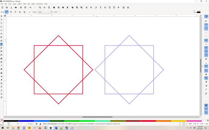

So I thought I’d manually try to make it happen. I made 2 shapes, line art with 0.025 stroke width. Traditional filled shape in red, parallel lines in blue:
I’m calling the blue technique a “score engrave”.

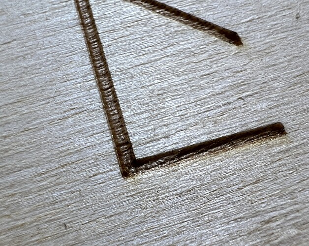

Traditional engrave detail:
Clean, but you can see the clear “U” shape of the engrave. The edges are not as crisp as you get with a score engrave. See the next picture.
Score engrave detail:
Flatter bottom, more consistent depth.
Score engrave detail (2):
Sharper edges, the points of the tight corners are sharper than the engrave. Not by much, but it’s there. Might matter if rendering text at small pitch.

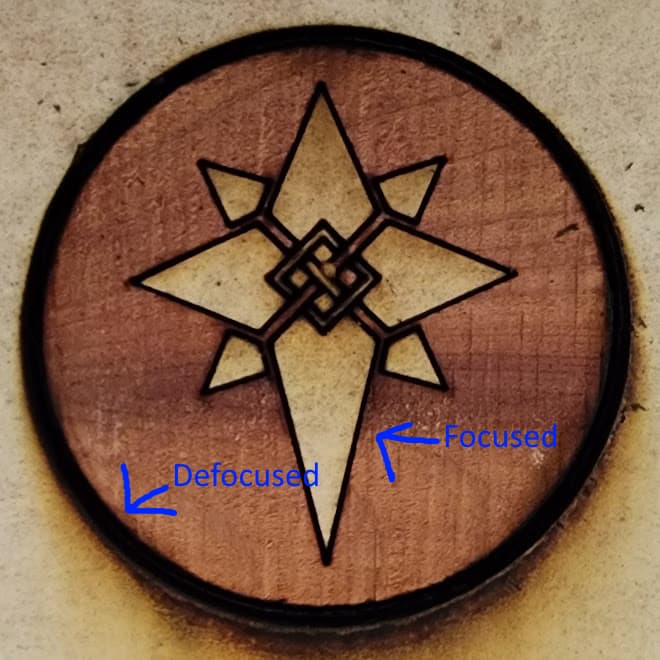

Why not just defocus to get wider lines? Defocusing does exactly that: defocuses. YYour corners will be softer by definition, the laser isn’t in focus. Also, it’s not the most predictable technique – with practice you might get a dialed in line width with a defocused engrave – but this is 100% consistent. I think this technique has an edge on those two points. Defocusing will be faster because it’s just one pass or fewer passes depending on how wide your desired line has to be, but this may be worth the tradeoff.

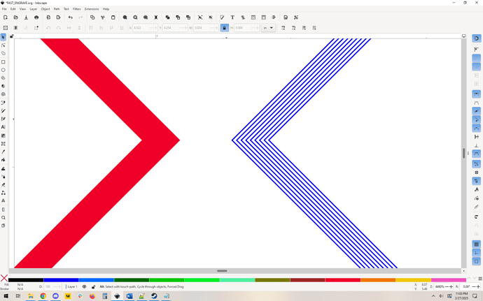

Not really.
  • Select original path.
  • Set stroke to desired width, in this case I wanted a 0.003” gap so the stroke was 0.006.
  • Duplicate the path. I use copy and paste in place.
  • Stroke to path (inkscape). Some pathfinder command in illustrator.
  • Paste in place the original path again. Set stroke to 0.006” more (0.012). Stroke to path.
  • Again at 0.018.
  • Again at 0.024.
Done. The line sort of grows outward from the original path as you go. I chose 0.25” width to make the test reasonably simple and fast, you’ll need to do more iterations to get wider lines, but it’s a pretty fast workflow.

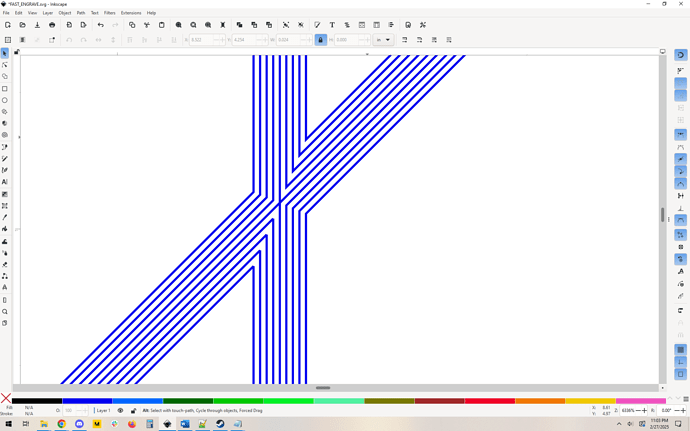

Hmm just thinking about it you could do it in fewer steps with a clever binary approach. This means that it would be pretty simple to make engraved lines of almost any thickness.
It’s hard to write up how it would work but you’re basically taking advantage of the fact that every time you do stroke to path you convert one line to two. With a little forethought you can make colossal lines with few operations:
Operations Number of Paths Width (inches at 0.003” gap)
1 2 0.006
2 4 0.012
3 8 0.024
4 16 0.048
5 32 0.096
6 64 0.192
7 128 0.384
8 256 0.768
9 512 1.536
10 1024 3.072
11 2048 6.144
12 4096 12.288
13 8192 24.576
14 16384 49.152
15 32768 98.304
So yeah in 8 operations you could get a line that’s a bit over 3/4” thick, which would take 128 passes. I can’t say what kind of time savings you might get, it’s depend heavily on how much white space your design has. Essentially large hollow ring-type designs are where you see the biggest gains, as you’re saving the wasted time that the laser traverses across the open space.
Also I don’t know what hardware you’re working on but step #15 would cause my computer to absolutely combust and it tried to make 16,000 paths at once. That being said if your path is 98” wide I don’t think even passthrough is going to help you.
In reality step 7 creating 64 paths would probably make inkscape pause. Step 8 making 256 would probably make it pretty sad and I don’t think I’d ever attempt step 8 with 512. It just doesn’t like things that are that complex.

Go into manual settings and set the height at .5
Voila, defocused line.
or
1/2" material
Go into manual settings and set the heigh at .01
Basically manually get the focus as far away off from your material height as you can (1/4" being about the minimum and 1/2" the sweet spot IMO). A score line will go from .007" wide to about .07" wide at the 1/2" variation, and about half the normal depth.
You’ll see it accidently if you misfocus something too :slight_smile:
For more tests of defocus…
Extreme defocus including no lens:
And traveling salesman:
