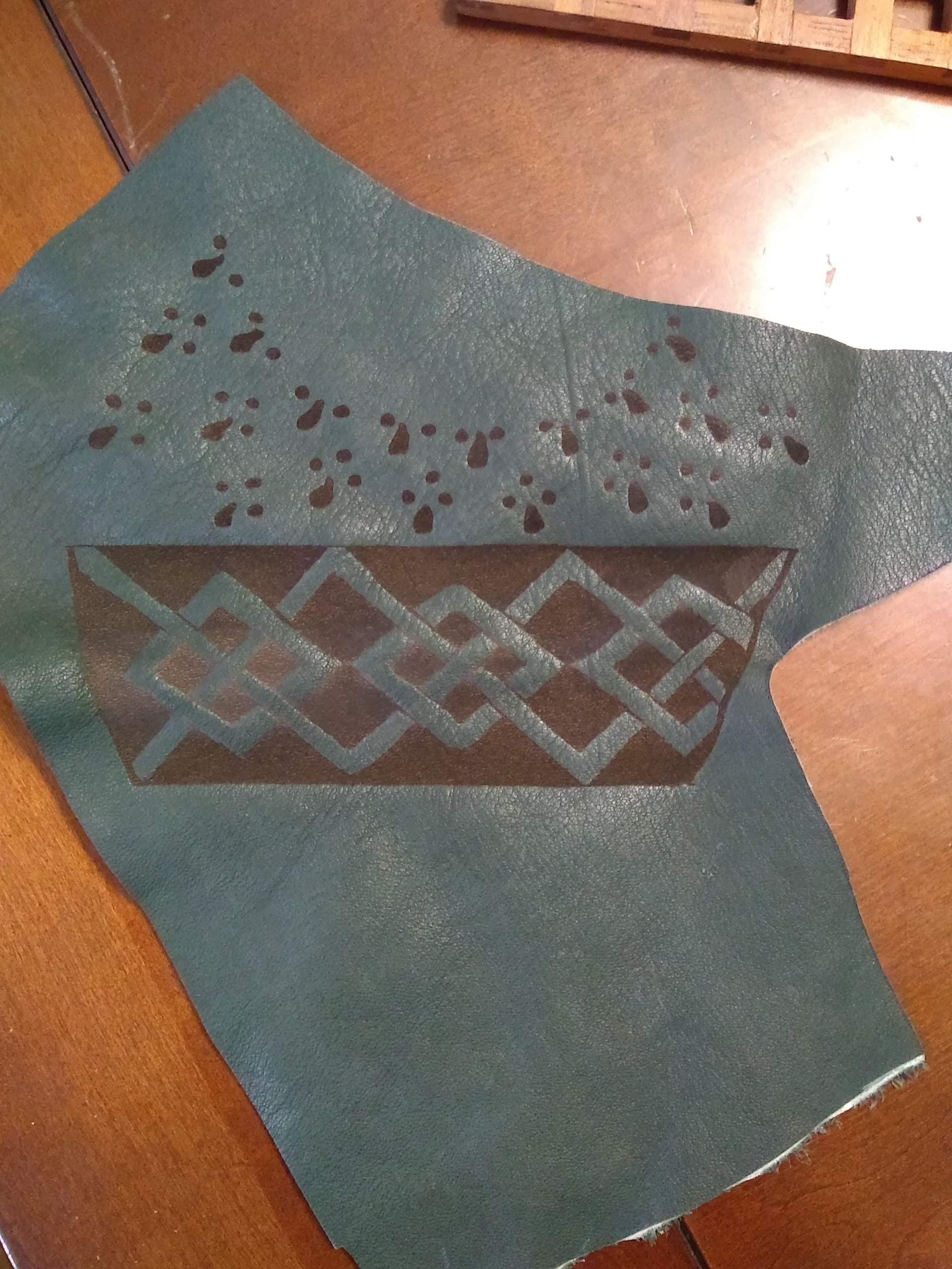

I have been a leatherworker for decades, one of my earliest projects on my 'forge was engraving designs into the flat pattern for a leather shoe :slight_smile:

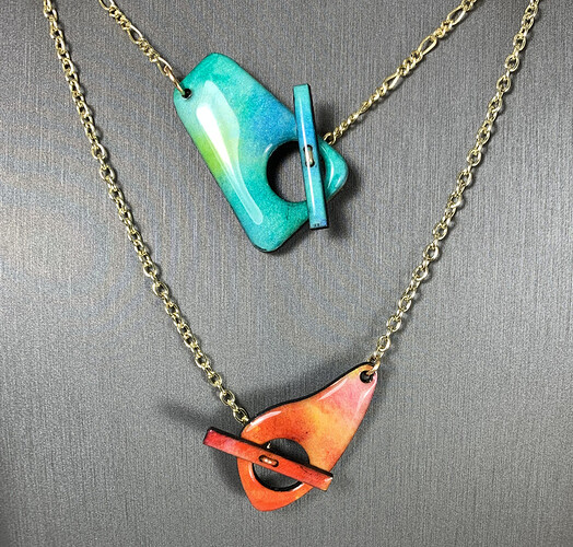

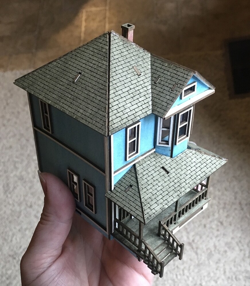

I like to use Canson watercolor art board for projects. You can color it with watercolors, then seal them and it cuts beautifully on all lasers, Aura and Spark included. Here’s a couple examples I have done:
Pendants, coated in resin after cutting:
Miniature house:
The cool thing about this material is it’s about 1/16” or 1.5mm, so you can often take a design intended for 1/8” material, resize to 50% of the original, and cut as is, and all slots and finger joints will fit.
Hmm… wondering how the Epson “Eco-Tank” printers would handle this - mine feeds from the back only and handles envelopes well…
I love these!
