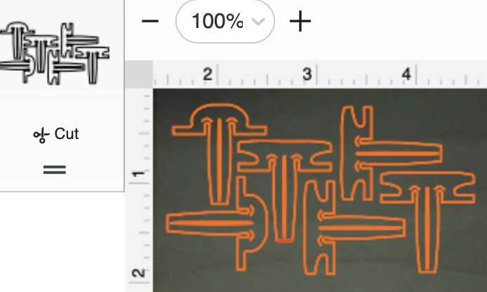

If it’s a job that uses a significant amount of material, I always pin it in place, and never, never move a sheet from the bed until I’ve confirmed the pieces will lift out. I keep a pick on my machine for that purpose. Another trick I learned was to elevate the edges of the material slightly, so the cut parts drop down. I have a design for a hold-down pin that does this automatically. Obviously the material needs to lay flat, but I rarely have any that isn’t, or needs just a tiny bit of force to straighten - the pins are enough.
Edit.. found it. I thought I’d called it “raised”, not elevated..
Thanks for sharing, I’ll try them!

Great idea! I’ll try maaking some raised pins.
