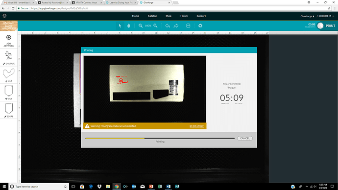

I made the founder’s ruler along with the other items in the tutorials using the Proofgrade materials. Before I finished, I received a “Proofgrade Warning” indicating that the material in the unit was NOT proofgrade. What did I do wrong?

The Proofgrade not found error can happen if the machine takes a measurement off of the material - it’s verifying the thickness and giving you a warning so you can check to make sure that the right material/settings are in there. You can ignore it if you actually are using the material shown. (Happens once in a while if there are cutouts in a sheet.)

The non Proofgrade warning just means that it didn’t read the QR code. Either lighting was off or perhaps a previous cut had lopped off part of the label. Nothing to worry about. You can always select the correct material from the list by clicking in that rectangle wher it says the material type.

I also ran into the same problem with the machine not recognizing a PG maple sheet, but I noticed that a highlight from the LED lighting reflected off the QR barcode was preventing my machine from recognizing the material. Once I moved the PG sheet slightly so that there was no highlight, it recognized it. From your photo, it also appears that you have the same problem.
