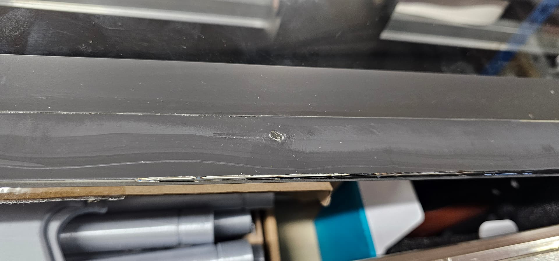

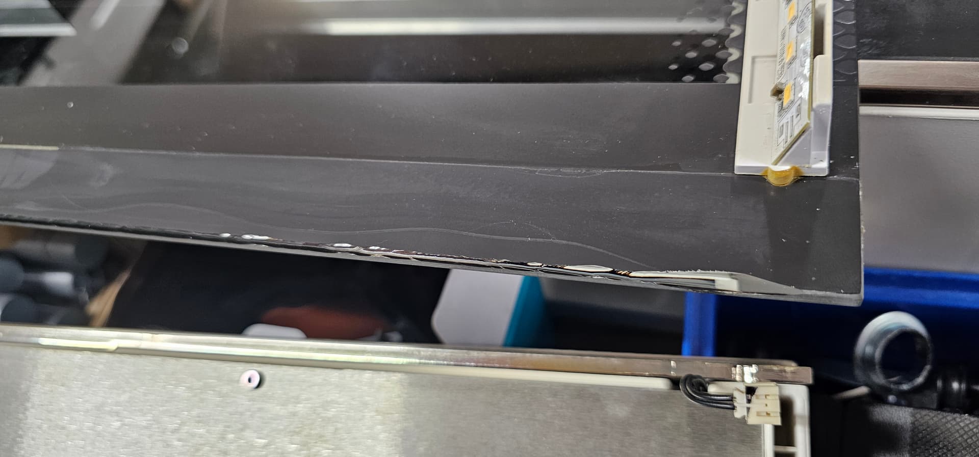

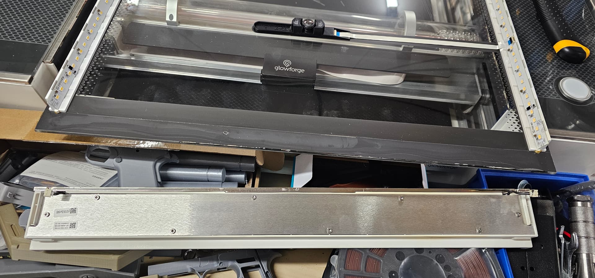

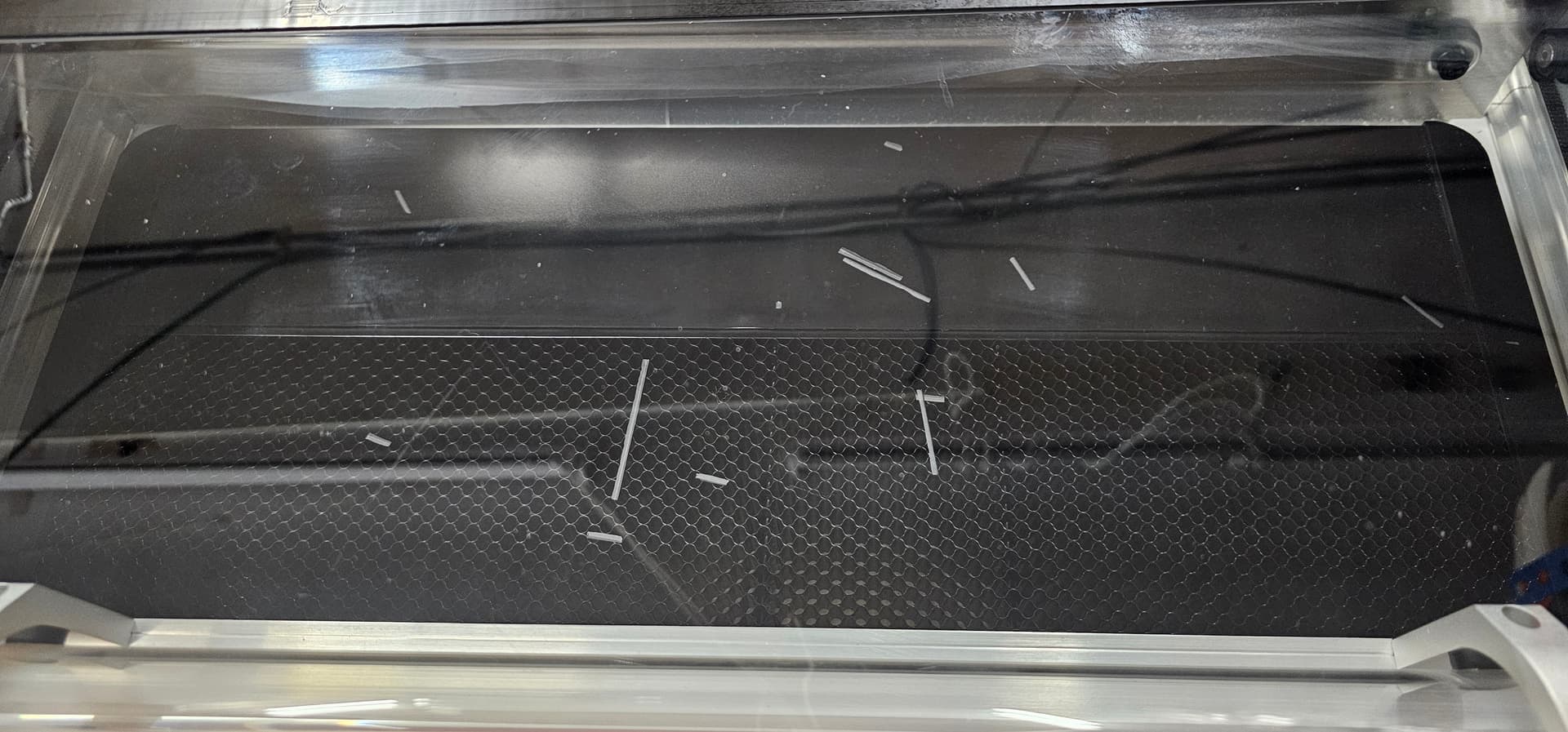

Just when you think the joke is over after having paid 150+ to ship a 20$ part overseas, I’m in the middle of reattaching the lid black wire/cable and the handle unglues sharding the glass and tearing the solder connectors in the process…
Hoooooooly fffffff…k
How fun of a piece of hardware to choose such a poor (glue) solution.
So apparently I’ve soldered the pins the best I could but it’s not enough and the GF app reports LID OPEN.
