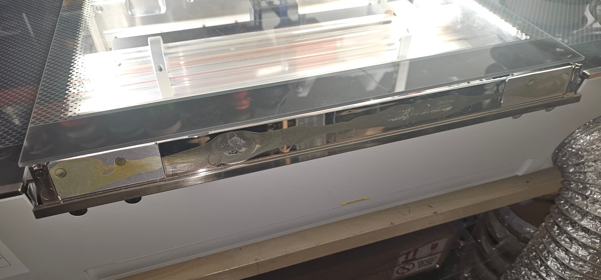

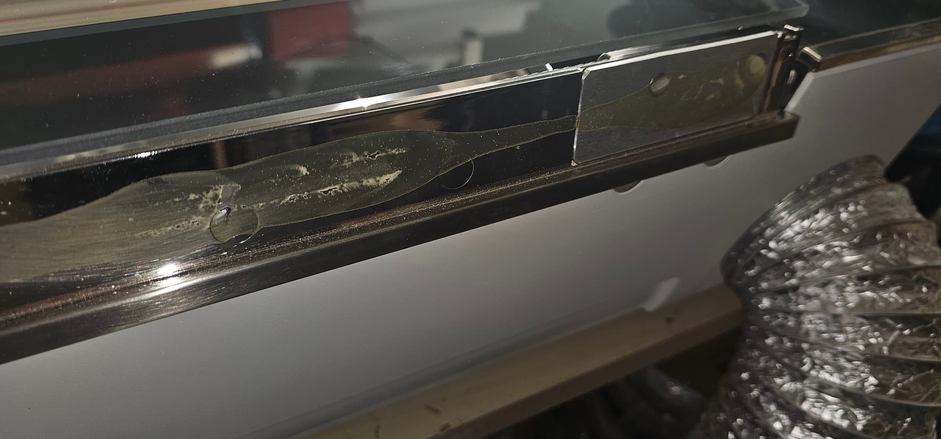

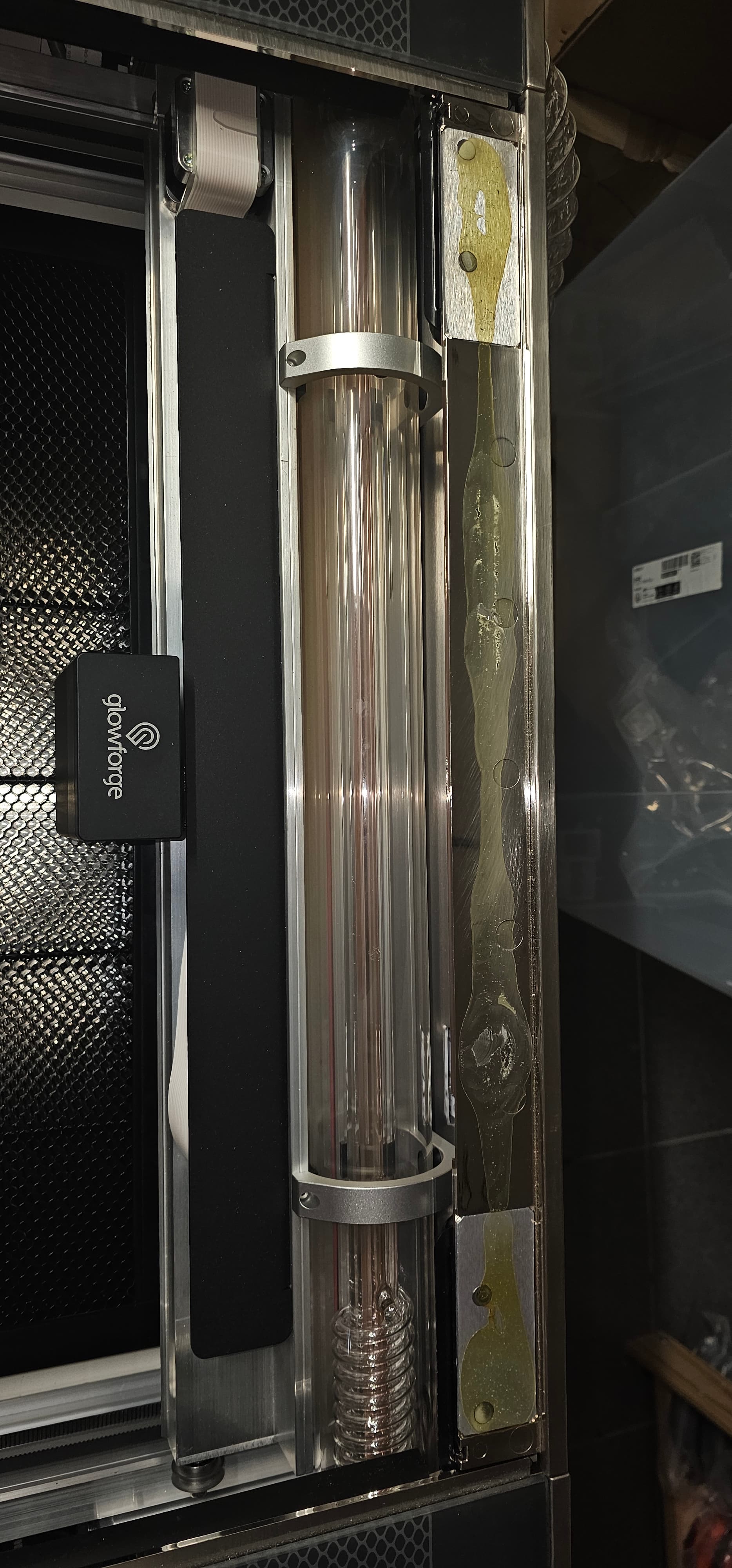

Today after opening the GF to clean up the tray, I went to close the lid and a big CRACK gave me almost a heart attack…
Luckily it was just the door being unglued drastically from the hinges but I as totally new to this issue… Until I read some more, and more, and more posts about this here on the forums.

Anything in the space between the lid and the lights can put huge leverage on the hinge. If there was a loud sound, that was the force exceeding the strength of the lid which means it was pretty strong.
If you mean foreign objects, nothing was there. The crack was the “clean” split between the glass and the glue all at once :frowning: Dry crack of course.
The hinges are stiff by intention, very difficult to move without the leverage of the glass lid attached. That stiffness is what holds up the lid and keeps out from slamming shut from gravity.

I’m going thru difficult times with my health and financial situation, and am losing my home. My family has been rescuing personal and valuable items, so my GF was carried as it sat on my workbench into the back of my SUV, and transported 12 miles and down a VERY bumpy driveway - thankfully I keep those thick foam tiles in the back for my dog’s comfort, plus it was also on a folded moving blanket.

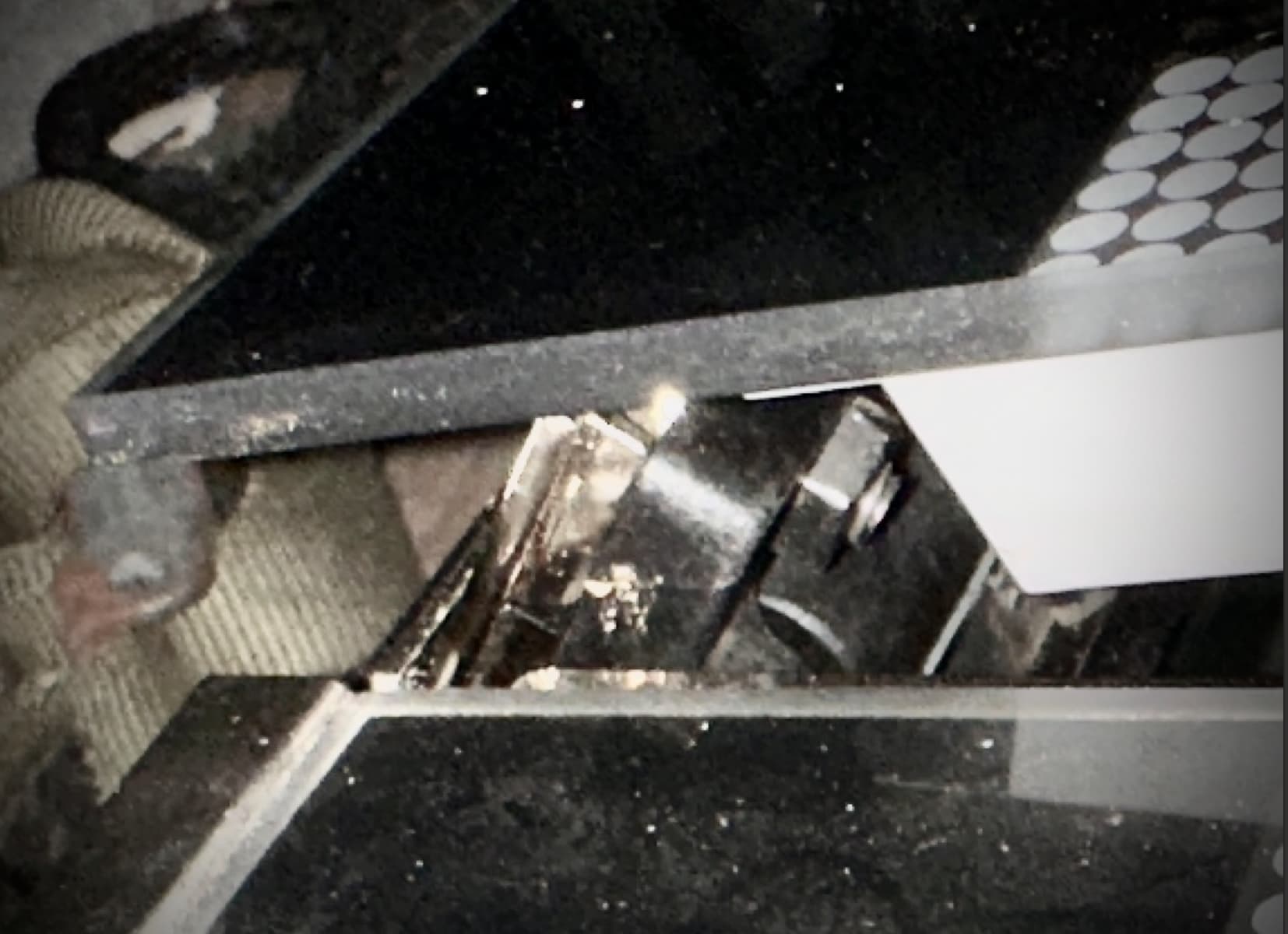

The tray was still in the machine, and to make it easier for my daughter to carry the machine around to the basement, I had her open the lid. As the machine was in “backwards”, we had to turn it sideways and when I opened the lid, it popped free on the left side. I hurriedly removed the tray and pushed the lid down as far as I could but the hinge was open about 30º so that corner was sticking up.

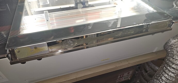

I’ve just started navigating stairs and felt strong enough to go down and take a close look, and some pics. I found I was able to gently, but firmly, press the hinge back to its closed position, so the lid sits (almost) flush again - I need to shim under a foot to get it perfectly flat.
I am happy to report, however, that I was able to flip to the wifi here, then perform a quick test print. I inserted the tray, and a piece of cardboard, by slightly opening the lid, and sliding in the tray with the material on top.
So the machine survived the unorthodox relocation, now I need to figure out which adhesive will be best. I have about 4 good options to consider right here already.

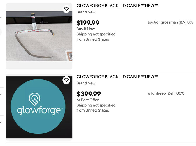

I had the same thing happen to me, I did a temporary fix with 5 minute epoxy but unfortunately it was a temporary fix. I did it a second time but to no avail. I finally purchased a bracket from Ebay that you can install with your lid & it permanently fixes the problem. I had actually ordered a new laser at the same time & I decided to just go with the new laser so the bracket I have was never used. I’m willing to sell the bracket if your interested. Let me know & have a great day.

For what I’ve read It’s just a temporary patch no matter what glue you stump up there, the design on this lid is definetly a flaw on the drawing board :frowning: The forces implied seem to make any glue succumb after any amount of use as per other’s experiences.
The ebay aftermarket solution seems the cleverest and long term-est solution so far. I just ordered it.
Hah!
I just replied eflyguy about the “temporary patch” any glue is, the ebay bracket and I just read YOUR reply, damnit! I already paid for it! So may be eflyguy will now grab yours :wink:

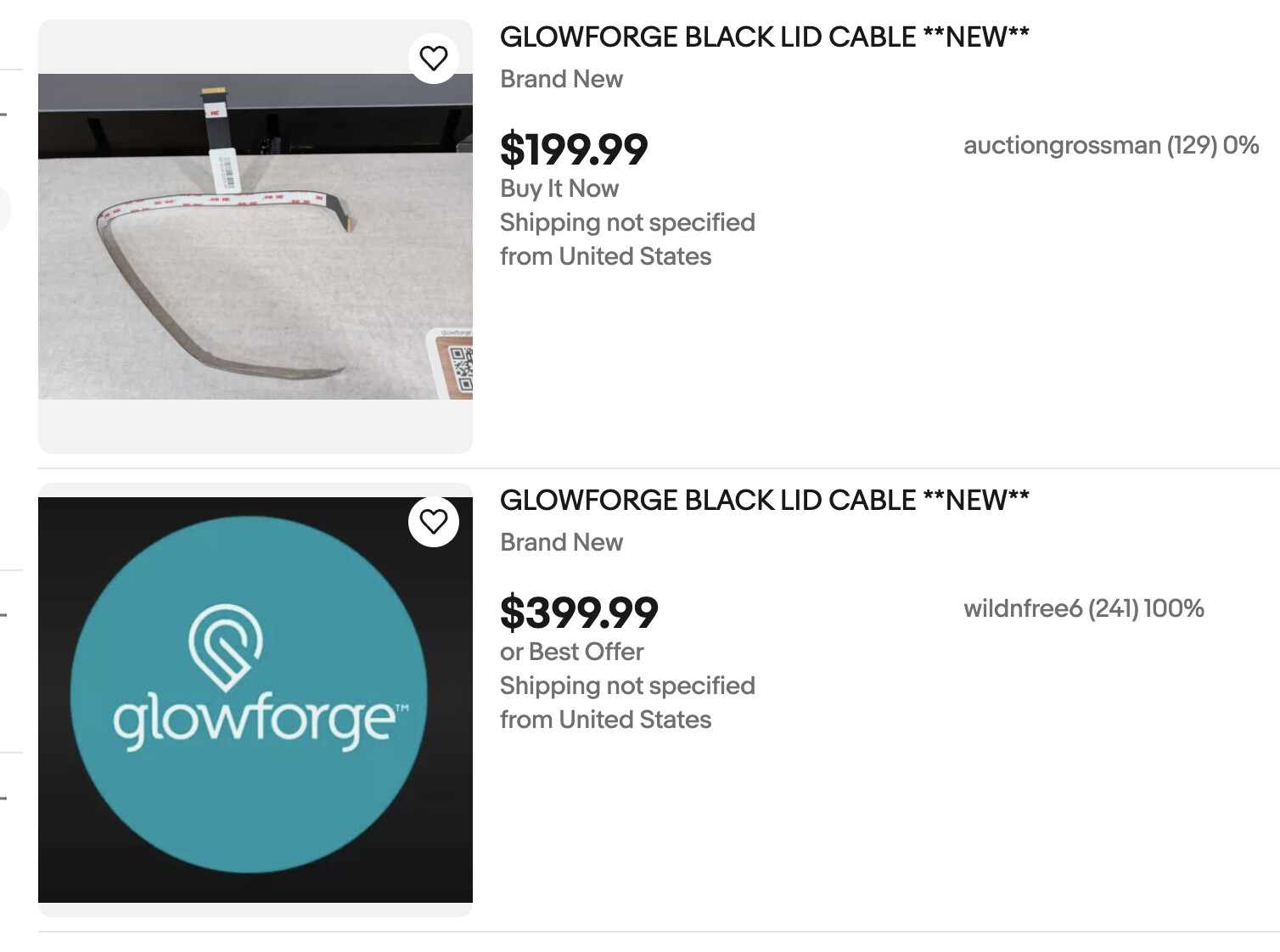

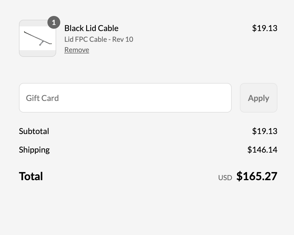

Apparently now the camera won’t take a pic so may be the cable died in the process!!
Sooooo… guess what??? “Get a new cable!, it’s only $19!”
SUUuuuuuuuureee!!! xDDDD
This is plain and simply RIDICULOUS!

$146 shipping may have to do with the current tarrif insanity. To the poinr it is not, there could be more purchases added to the total without increasing the shipping or make much better dropped entirely.
I have done this on several occasions.
The shipping out of the US shot sky high when they started using carriers instead of regular mail. It’s been that way for years. Are used to ship stuff all over the world, until the carriers increased their prices back in the mid-2000s.

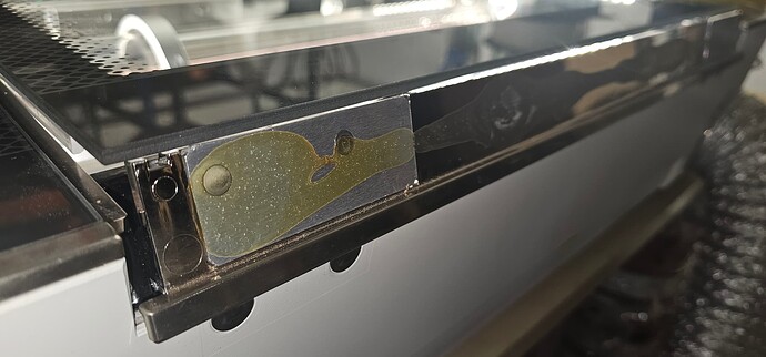

I had the same thing happen and I used this solution from @krsnaday: Lid Hinge and handle reattachment
Here is the exact product I used: Amazon.com
Take the time to clean off as much of the old adhesive as you can. Get as many clamps on it as possible and let it sit overnight. Mine has held strong for almost a year now!
