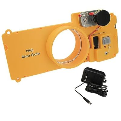

What do you guys think about this for a blast gate solution?
Man… u got a glowforge! Cut a manual blast gate out and glue it together!
Or this one :slight_smile:
https://www.mcmaster.com/#38405k92/=18oqh9s
That’s the one I’ve been looking at for when the weather outside turns cold here.

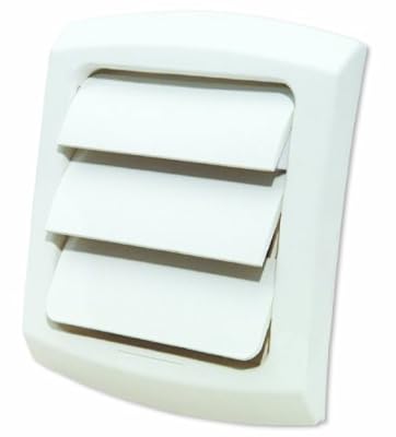

FYI, this is the vent I have. It still lets the humidity in.
That’s a heck of a lot fancier (and pricier) than you probably need. Mine’s just a bunch of hanging flaps. They get pushed up by the air flow.
(Okay…now I’m haunt…it’s actually not a blast gate - it’s called an exhaust cap.)
Anyway, it works just fine.
Mine has one flap on it, and the hinge is at the top of the flap.
I could adjust the closing force on it by adding a weight onto the bottom of the flap.
https://www.lowes.com/pd/IMPERIAL-4-in-Dia-Plastic-Preferred-with-Guard-Dryer-Vent-Hood/4753378
That’s clever. We get condensation in our dryer fairly regularly - we live in Georgia (state, not country), so hot and humid days are pretty par for the course - and I will definitely try this.
