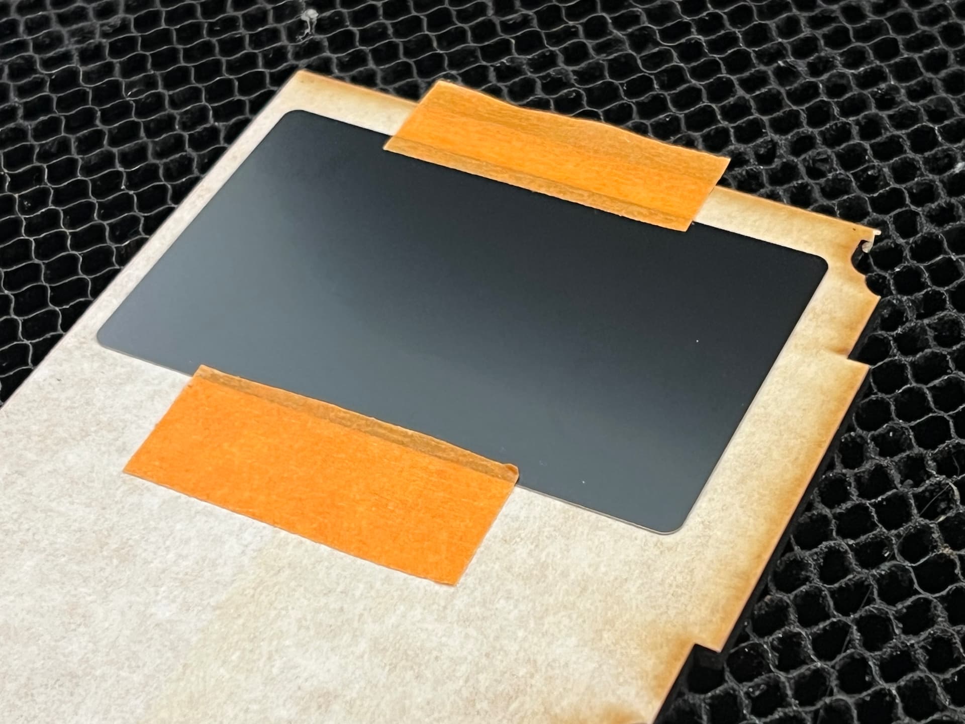

Still in the process of clearing space for the F2 Ultra UV laser, but in the meantime was curious about the pack of metal business cards I added to the order. Given how Amazon’s vendors sell these at around 23¢ apiece, xTool’s pricing (as of Dec ‘25) sliding under a dime made it a no-brainer to investigate.
Not having any exposure to metal cards, the brain kept thinking these were going to be delicate and crumple-y like aluminum foil, but in reality it behaves and flexes much like plasticized cardstock. I’m sure if bent beyond a certain radius, it’ll permanently crease, but so far it’s behaving far above my expectations of it.

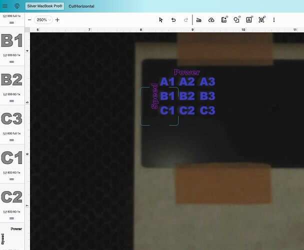

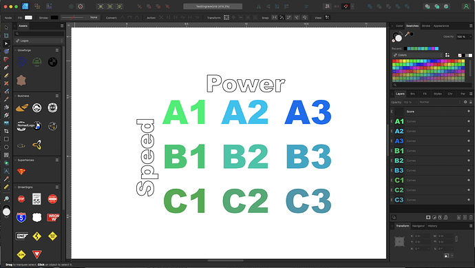

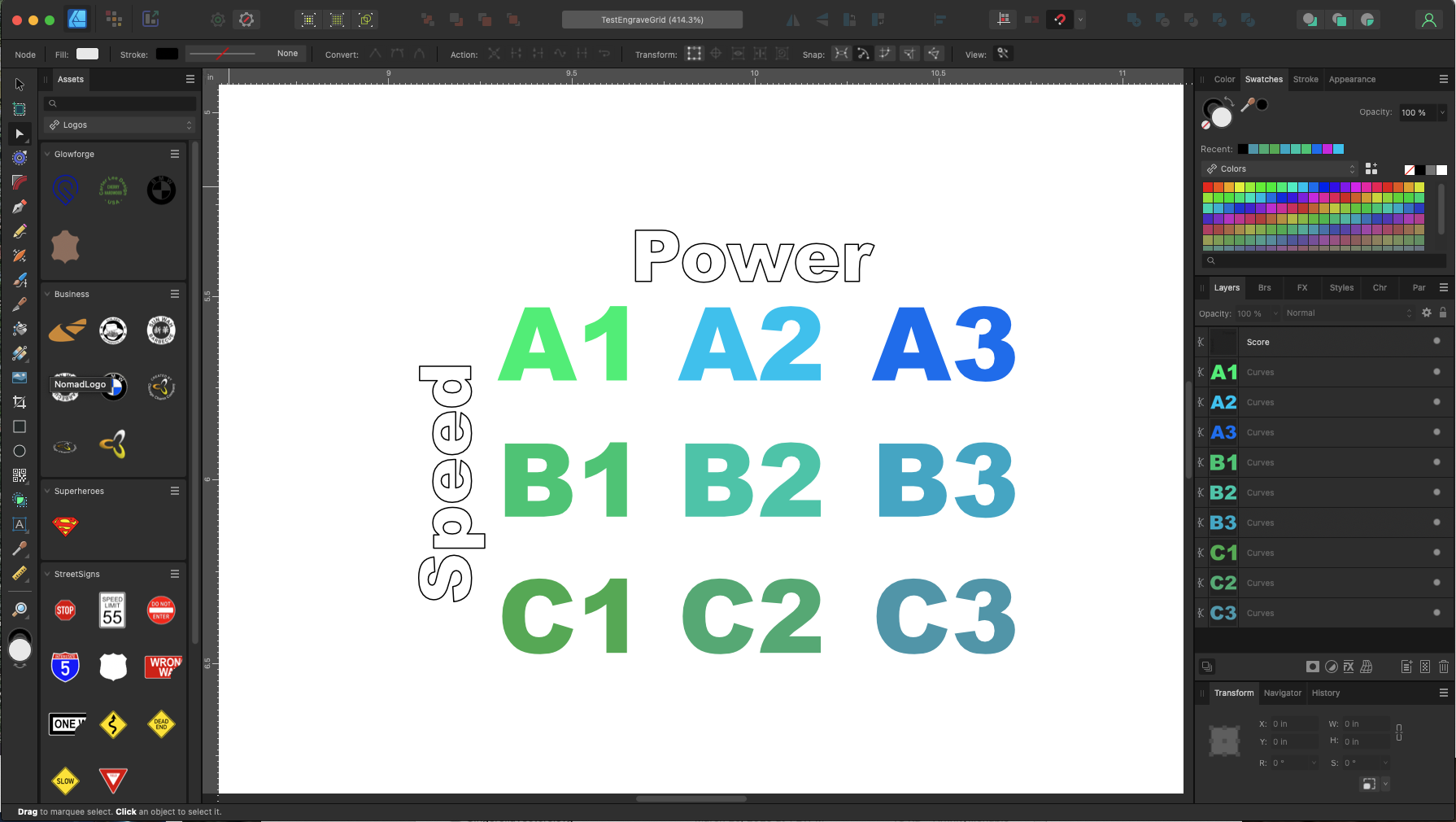

I’ll start with a 3 x 3 grid and space-out the VALUES enough to give me a sense of what’s going on. As usual, I fired up Affinity Designer to whip up the grid.

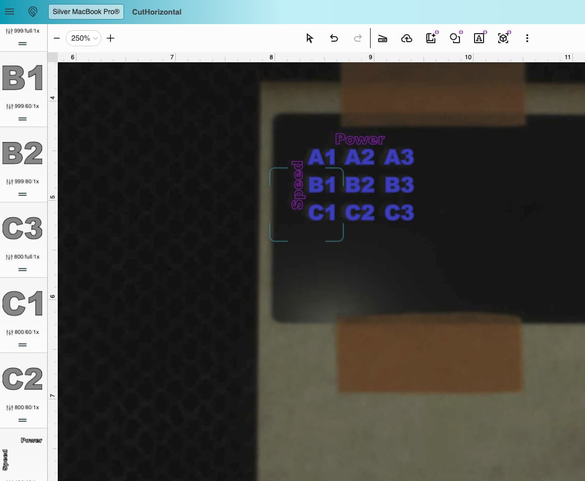

Each grid entry got its own shade of blue so that Glowforge considered it as a unique item. Also made sure that “A” and “1” were combined to a singular layer. When exported out to SVG and brought into Glowforge, the left edge thumbnails make it super-easy to tell which grid item I’m making settings for.
The final part of this is to populate the settings for each grid item. It helped to jot this stuff down and avoid further confusion. I pulled the Glowforge setting for engraving a MacBook as shown in the boxed value. Then, made variations to speed and power.

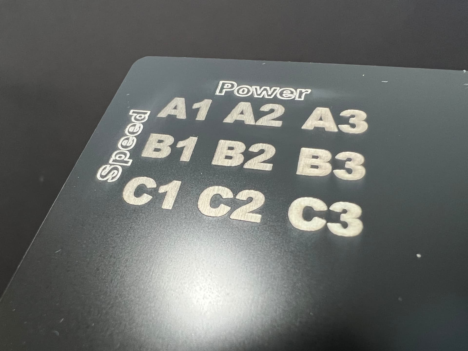

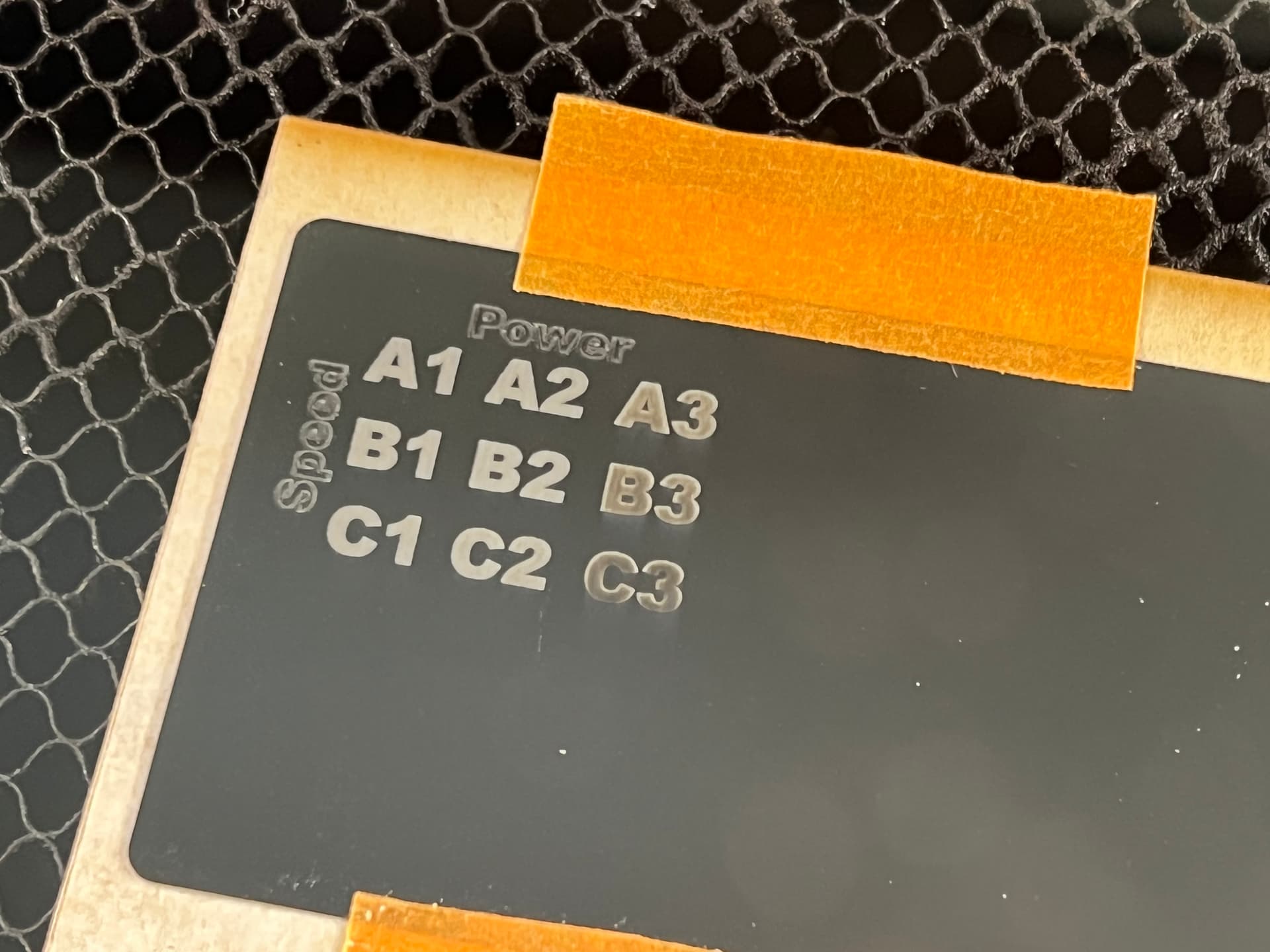

I didn’t really care about laser-scoring a business card, but made note of that value too just so I can see what the end-result was against the value settings.
The result showed I was right to pursue testing as the MacBook default value provided an unwanted charring. In-person, B2 looked the best to me and now the values I had jotted down can be entered into the Settings Journal I still constantly curate and refer to.

In the images it looks like the default settings left a very silvery look, while the others were more grey. It’s that just an artifact of the image or do you see that in real life too?
If yes, that may be a reason to use them with masking to get the silvery but without the overspray.
Hopefully this Glowforge engraved clip illustrates the level of “shininess” from ablating the anodization. Not a high-polished shine, but certainly “reads” as metal lettering. The others have a touch of soot.
Now that I’m revisiting this, I grabbed a paper napkin and just started dry-wiping the lettering including the laser-scored words. Not a shabby clean-up, but I’d hate to spend time scrubbing a full deck of these metal cards:
When/if time permits, I may start investigating engraving with images, though I suspect Glowforge might require some dithering/halftone setting activated. XTool’s product page for these cards show some enticing examples:
Gotcha, so nowhere near as different as it looks in the first picture, just excess soot :slight_smile:

A quick wipe with alcohol will make the engraves really pop on metal like that.

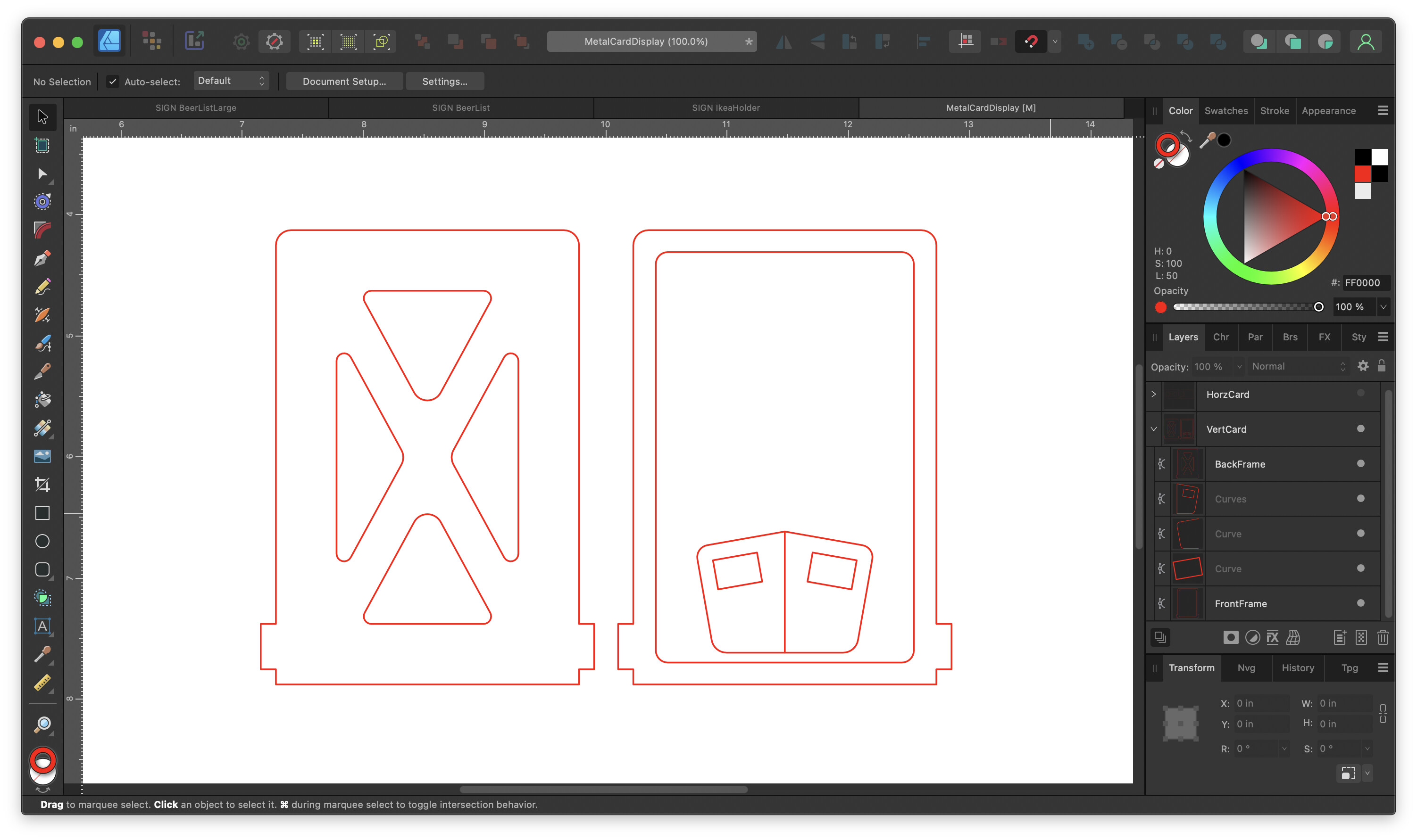

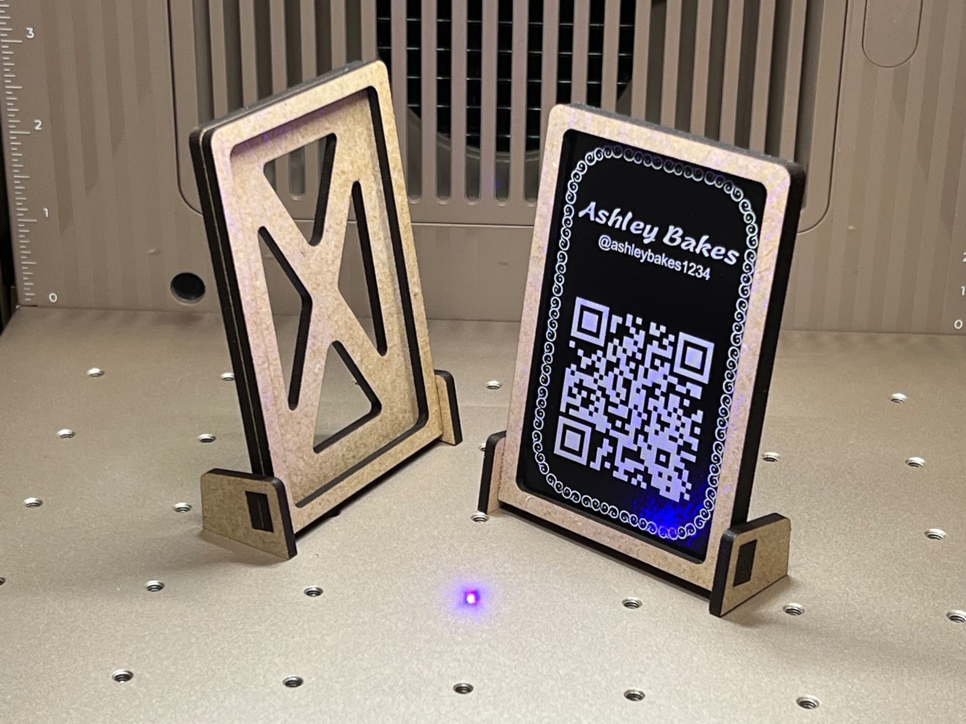

For the beginners who don’t know, design programs ought to be ambidextrous when it comes to unit types. For instance, in Affinity Designer, even though the document was opened with units set to SAE (inches, feet), going into a rectangle’s Transform Settings, it throws zero complaints if I type-in a width and height of “54mm” and “86mm” A custom display frame is made and sent to the Glowforge.
A light schmear of glue sandwiched near the edges followed by the side feet keeps this together. Perfectly tailored display for the metal card.
Files made for horizontal and vertical orientations. I believe this is the same ubiquitous size for other rounded corner cards.

Very nice. Thanks for the design. I’m going to use this for my neighbor!
Nice card and holder! And thanks for sharing the file!
