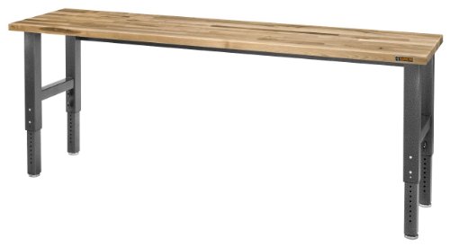

I bought this kit.
https://www.amazon.com/gp/aw/d/B0030T1BRE/ref=mp_s_a_1_2?ie=UTF8&qid=1502984313&sr=8-2&pi=AC_SX236_SY340_QL65&keywords=2x4+Basics&dpPl=1&dpID=51IxjCHyB3L&ref=plSrch
