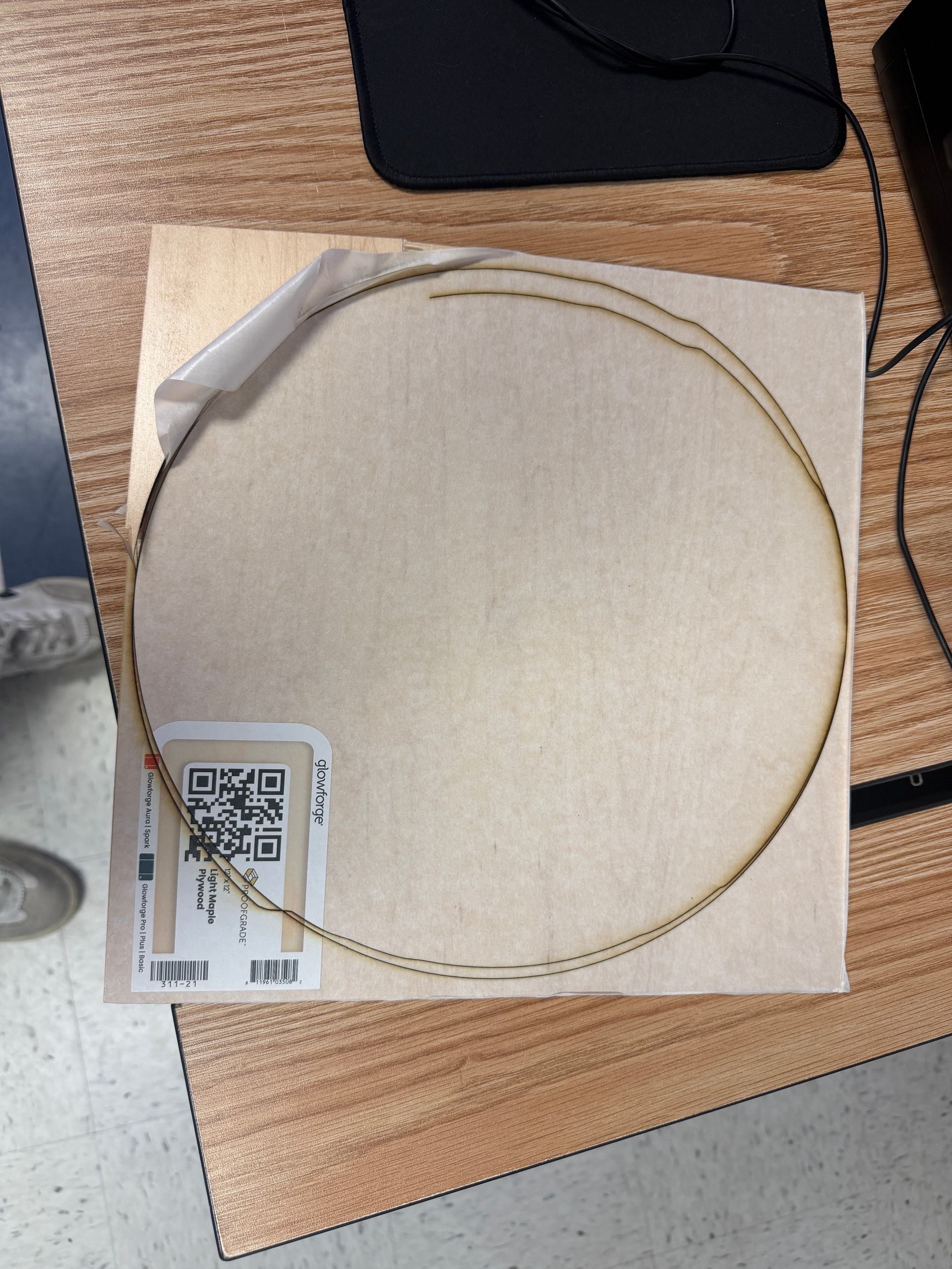

Whenever I use my Glowforge Aura to cut, the first cut is perfect, but the rest go off path. Any ideas what could be causing and how to fix?
With the aura it is extremely important that you keep your rails and bushings clean. You can find cleaning instructions here in number 17:
The conventional wisdom is that there really isn’t such a thing as cleaning the rails and bushings too often in an Aura/Spark. Some people claimed between every single job, because once the rails are dirty enough to cause a problem like this, the job is ruined and it’s too late.
