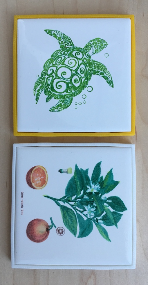

I too have been inspired by the cheap Lowe’s tile projects on this forum. I am getting better at manipulating the sharpies to produce the effects I want and I love old botanical drawings. They are beautiful and don’t have a copyright anymore. The dandelion is a work in progress.
I also made box frames with my 3D printer using flexible filament. These frames are instead of rubber feet and the back is invisible.
I also used some of my doodles.
One quick question: I tried applying a coat of acrylic spray paint but the marker color oozed out onto the white tile. I was able to fix it, but what should I do to prevent this?

Beautiful work! I too tried spray acrylic lacquer and had bleed problems . On the plus side they heldup well in running water and didn’t fade.
