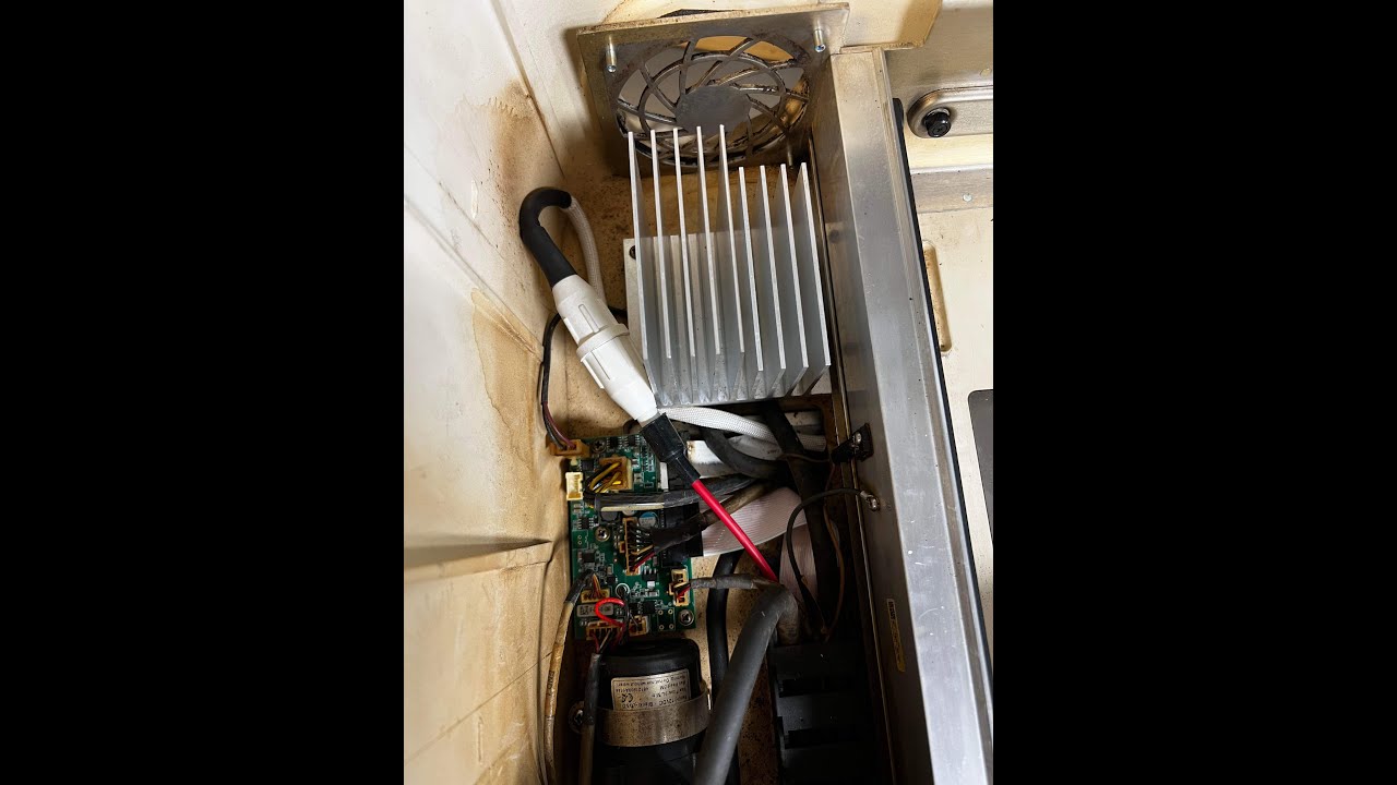

Update: I went deeper on this and found the actual root cause.
Put the machine in setup mode (hold button until teal) and pulled the device logs directly from http://192.168.192.1:3000/logs/zip. Found this in the glowforge app log:
ERROR: hw: laser supply current of 17 exceeds maximum of 12
INFO: hw: error flag set: fault:hv_current_alert:set
INFO: print: cut failed due to hardware error(s): hv_current_alert
The HVPS is failing. Looking at the full log history, the fault first appeared May 24, 2025 — which was the exact session where it errored out mid-print during my Glowforge support ticket. By November 2025 the current readings were spiking to 116-163 (max is 12). Today they’re hitting 188. It’s completely gone.
The pre-2025 logs don’t show hard faults, but the HVPS was clearly marginal for years — enough to engrave but never enough to sustain a cut. That explains why this machine has never worked right since day one.
I’m looking at replacing the HVPS — eyeing the Etsy seller (Ken) who pulls tested units from donor machines. A few questions for anyone who’s done this repair:
  1. Pro-specific HVPS or interchangeable with Plus/Basic?
  2. Could hv_current_alert ever be a connector/wiring issue rather than the HVPS itself?
  3. Any gotchas on the physical swap for the Pro?
Happy to share the full log if useful — tip for anyone debugging: setup mode exposes a local web server at 192.168.192.1:3000 with a /logs/zip endpoint that gives you the raw device logs without needing Glowforge support to pull them.
This sounds like a red wire short. Your power supply itself might be fine. If you’re curious about fixing it yourself:
This is super helpful! Is there a typical place these shorts usually happen? I’m trying to visually inspect it without completely disassembling it if possible, but that might not be…
That video shows the most common location. It’s in the red wire are usually right somewhere in the middle of the tube as far as I know. In any case you’ll need to inspect the entire length of the red wire to see if that’s your issue and it’s not always 100% visible like it is in that example.
I’m not sure if Wiregrass still sells a kit to repair this, they used to… But in the end all you need to do is get a high voltage wire that’s well insulated and replace that length of wire.
If that’s your problem. It’s not clear that that is your problem but you are getting a warning about too much current which seems to indicate a short circuit of some sort.
