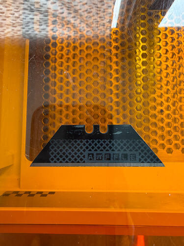

My artwork is lined up perfectly for engraving but the actual laser is off by about 3/4” both too low and too far right.

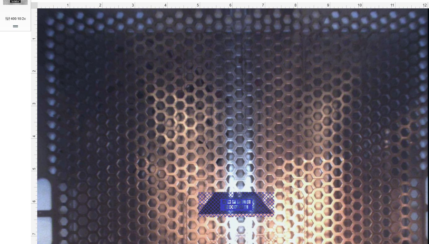

Could you supply a screenshot of your project showing the the design placement compared to the actual engrave placement?
