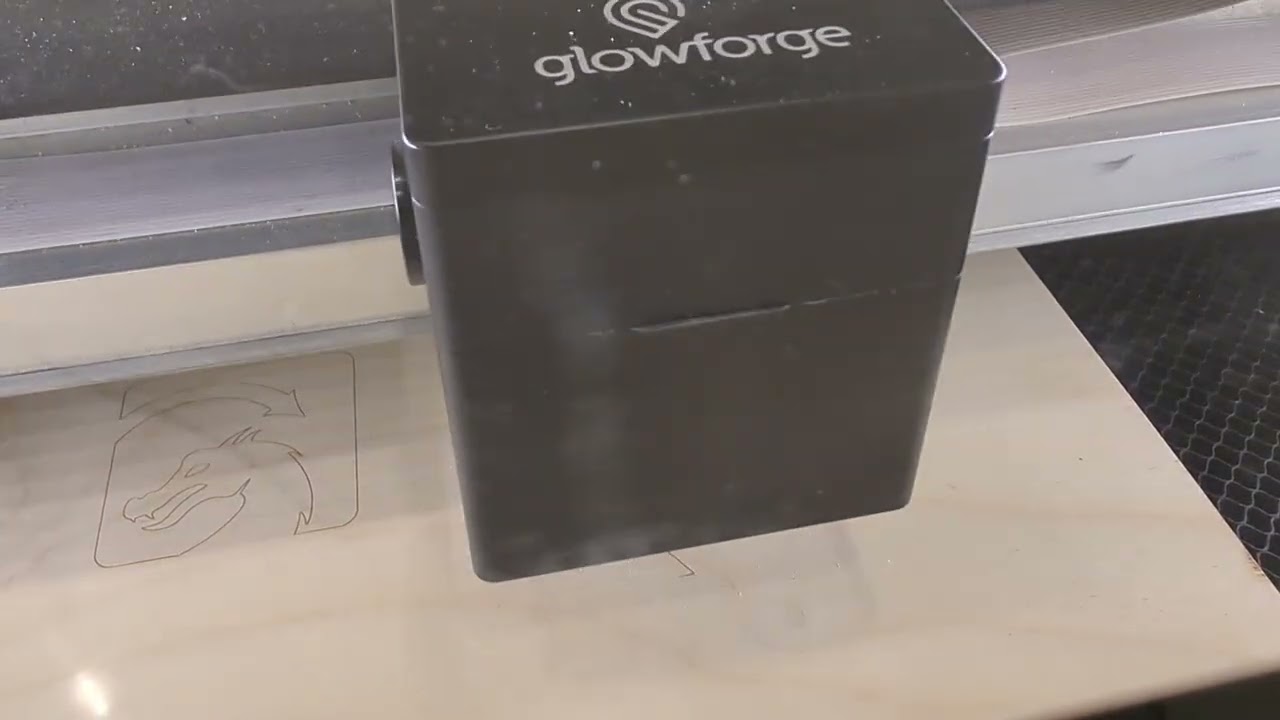

I took a bit of a detour, which ended up in the revival of the ForgeFIRM project (firmware that runs on factory Basic/Plus/Pro devices).
Anyhow, I have GRBL running on stock hardware. Working extremely well with LightBurn. It allows you to switch between GRBL and the Glowforge cloud service.. Best of both worlds, no?
