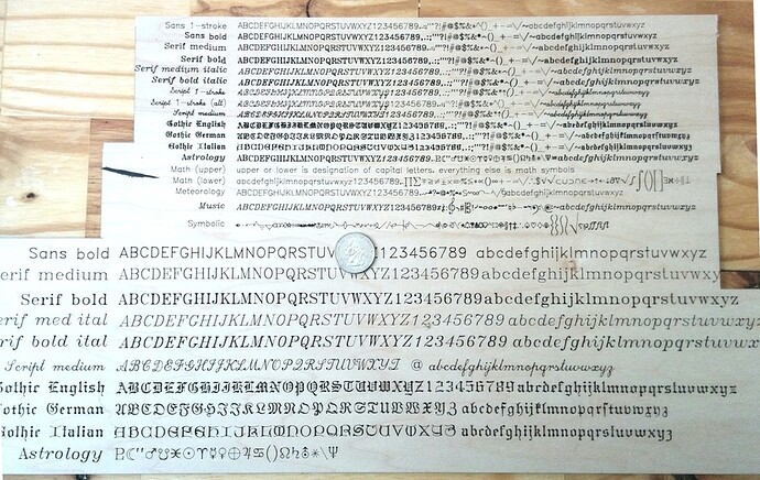

I wanted to see what Hershey Font would look like all lasered out, at roughly 12 pt and 20 pt (I think? ;p) Here is a pic of it on :proofgrade: maple, quarter for size reference:
A couple of close-ups:
and in a project, name tags for a local business:
There is definitely a point that making Hershey text much larger doesn’t look as nice, but if you stay below that, it can cut a lot of time off the lasering process.
