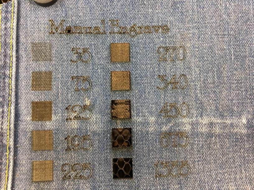

First a test pattern in Inkscape. Making the 1/2 squares different colors allows me to choose 10 different dots per inch resolutions available in the custom engrave list. The text is converted to vectors and scored/cut rather than engraved to save time but keep a visual reference.
I have a big box of denim clothes that I have been collecting through the years. One of these days it’s going to be a jean quilt. Until then it is a bottomless supply of material to process. I cut off one pant leg and opened it up flat on the bed and used magnets to keep the fabric somewhat tight and flat.
And with the text pattern overlay-ed. You can see how I designated DPI.
It doesn’t take too long to go through all the options. I kept the power on 1 and I kept it on the fastest speed of 335 in/min and one pass. Too bad at this time you can’t save it as a project, so get it right before you exit out of that particular workspace. But it’s not that big of a deal. A digital calipers is handy for getting the material thickness correct. I did these with a correct focus, but that would be another way of etching, defocusing the beam.
After the burninating is done, it’s pretty clear that the Glowforge has power to spare. Note the honeycomb in the holes by the highest DPI, 1355. Another way to do this is keep the DPI low and add more power, butiat seems that I want to keep power at 1 and DPI to 125 for a medium to light weight denim, .015" thick. Note the scoring of the numbers does cut. I forgot to take a pic of the ready screen to show what time the engraving would take but I think it was around 18 minutes.
Here is a photo after I lightly brushed away the char. You definitely can get some distressed looking jeans here.
Here is a closeup of the lower DPI effect. 35 does affect it but 75 seems to be the way to go to get that upper blue layer etched without cutting the threads.
Higher DPI definitely distresses more and starts making holes.
