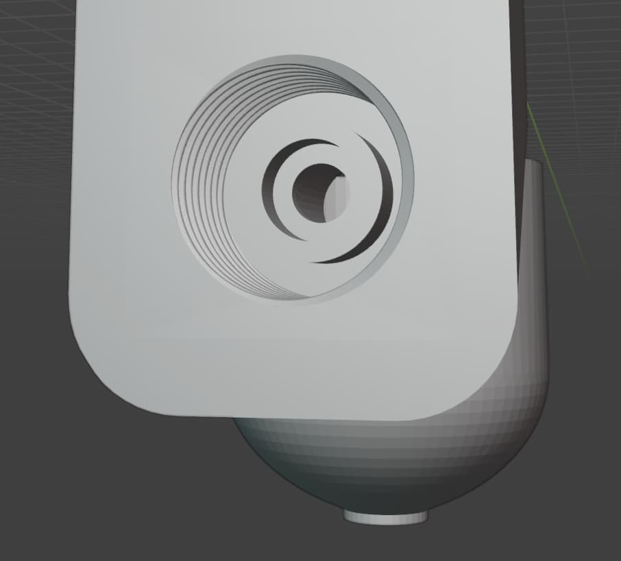

Guys, I did it. I made a custom 3D air assist nozzle that will hold a 6mm air tube so you can hook up an air compressor. I used laminar flow and I’m so close to having this thing finished. I’m running a few more tests and it will likely take 2-3 more 3D prints, but I’m close. I’ll share all the files once I dial it in.

Thanks guys. I tried a cut last night and it didn’t work. I realized my error and I did a redesign last night. I’ve got it 3D printing in PETG right now and I hope it works tonight. I will say that I did have to add another custom piece that I can show you all. Some of the modifications I made might take some of you out of your comfort zone so my solution may not work for everyone.

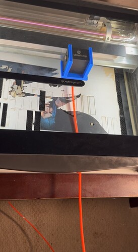

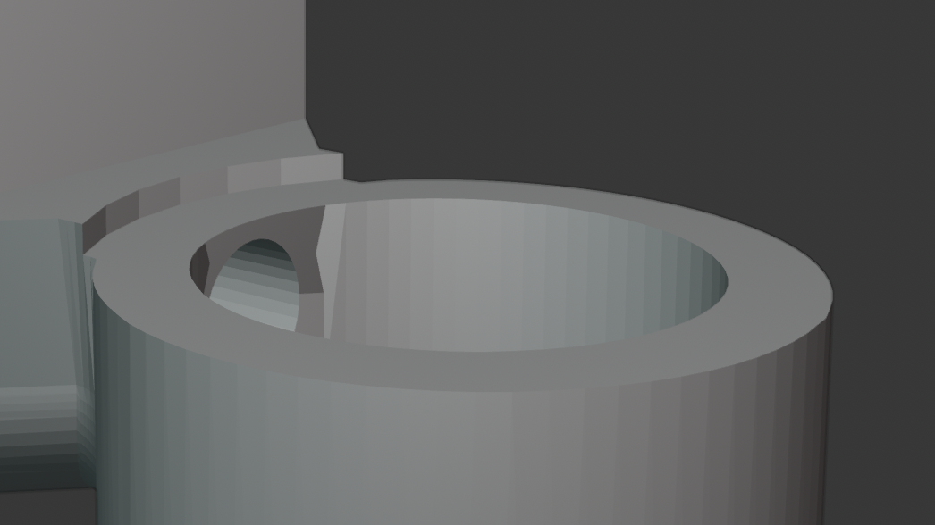

Hi Glowforge Community, I finished the laser head air assist nozzle to a point where I feel comfortable sharing it with you now. I have added the files and a link to an informational video.
Using super glue or some safe adhesive, you must attach a small rubber washer to the bottom funnel where I leave a lip. This gives it a nice tight seal and it’s totally worth it.
For the 3D Print:
  • Use at least 20% Infill
  • Use PETG, not PLA
  • Use 3D Honeycomb for the infill pattern
  • Use Organic for support style and use honeycomb for support pattern
  • Do not put supports in the inner tube or bottom chamber or it will get stuck. I recommend painting on the supports.
Glowforge Pro Air Assist Nozzle 1.1.zip (1.6 MB)

Thanks so much! I’m going to keep improving the design so you only have to drill a small hole or maybe even just put a tube through the pass through slot. I think using the chains is the way to go but I haven’t figured it out yet.
I imagine glowforge will add something soon. It seems inevitable that they will improve the air assist.
Also using a pump is totally fine and will help considerably. My oil free air compressor is probably a little overkill. Although I will say that when I cranked up the PSI, the cuts got even cleaner. No matter what, any extra cool air flow in there is going to help.

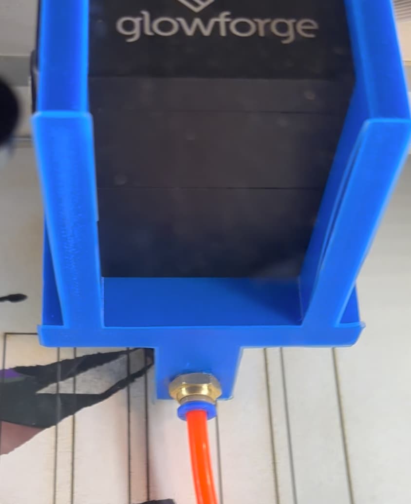

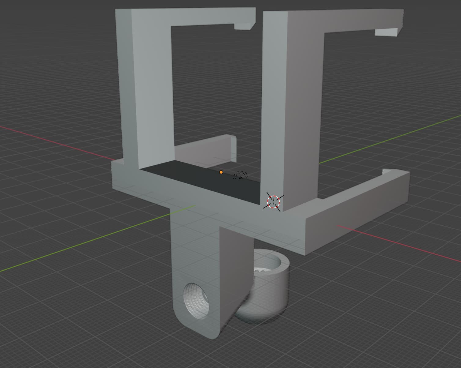

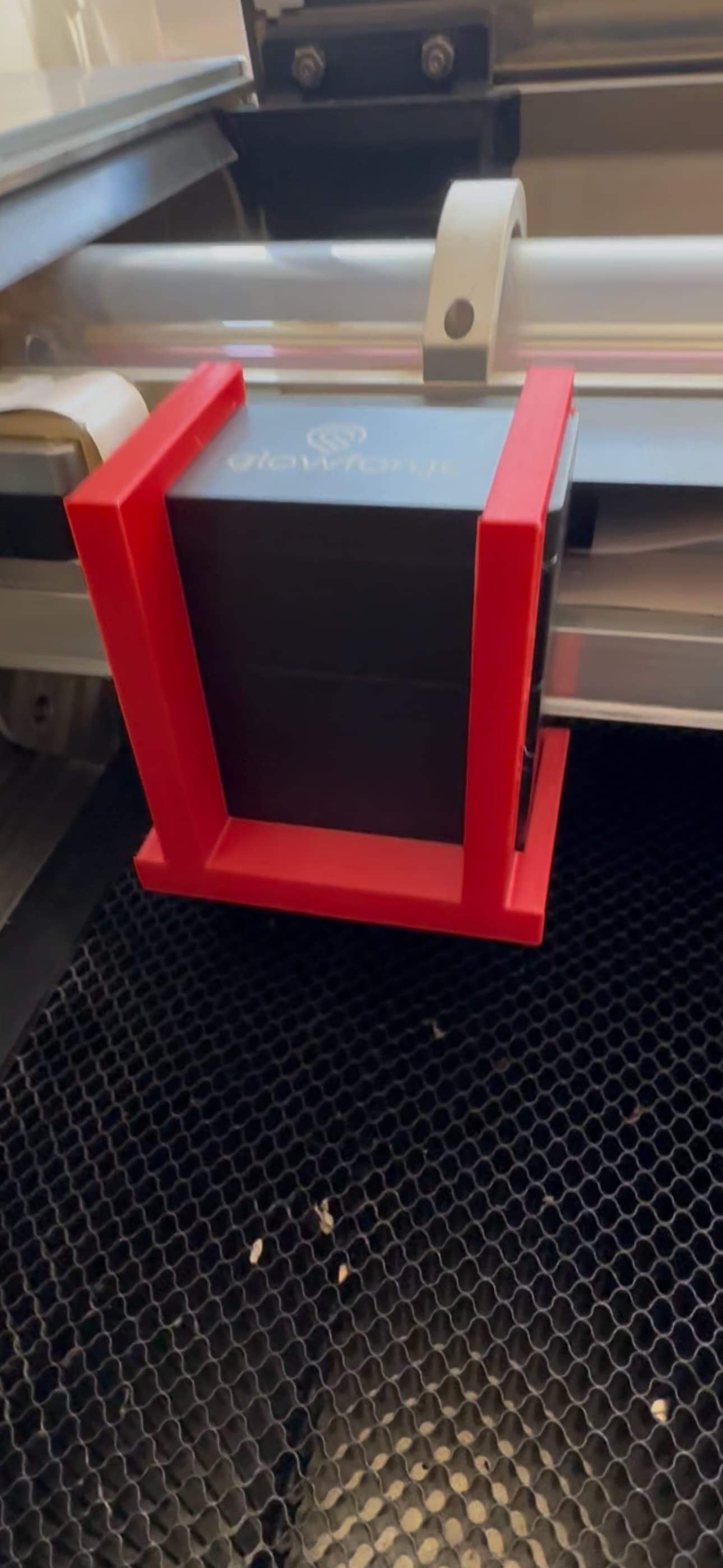

I had an idea to do a threaded slot at the bottom so you can put a bite type 6mm air tube fitting and have a nice tight fit. It also goes straight to the funnel now with no obstruction. Then, you can remove the flap from the passthrough slot in the front of your Glowforge and put the air tube in through there. If you support the tube correctly from up above, it should slide in and out with ease I believe. This would enable people to make this enhancement without having to do any permanent modifications or cut any holes at all. You can just add this attachment, hook up your air pump or air compressor, remove the passthrough flap, and support the tube from above and you should be good to go. I also added a little ridge where you can attach a rubber washer for an extra tight fit, I am testing everything tomorrow.
Glowforge Pro Air Assist Nozzle 2.0.blend.zip (1.4 MB)
made a new model where the air tube enters from the front with the air tube support from above so it’s not just dragging on the floor. I realize now that I need to design it so that the air tube comes from the passthrough slot in the back. Then this thing will really be great.
The air tube slides just fine as long as you support it from above and also remove the guard flap covering the passthrough hole. It has only 4 little screws.

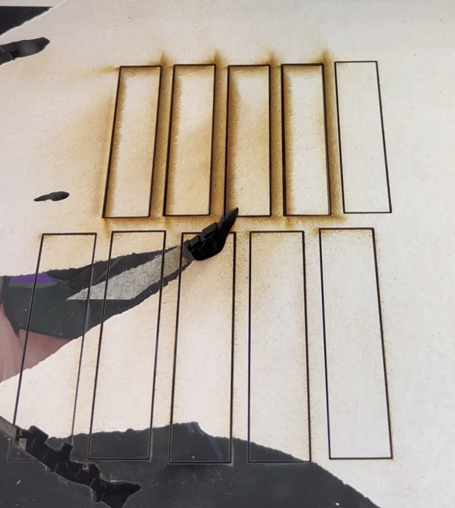

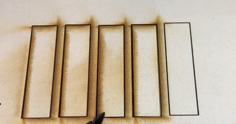

You can see from the photo below an example of 4 cuts with no air assist and then one with air assist.
I also did a few more cuts with air assist below that row. It makes a world of difference and it’s very clean on the other side as well.
I’ll be sharing the next design soon so it enters from the back so everyone can just plug and play this sucker. Also I created a threaded hole so you can put a push to connect fitting in there and it fits air tight.
Hey Guys! Here’s my update! I think I am happy with this version and I feel comfortable recommending this now.
Please watch this video for the full view: https://drive.google.com/file/d/1Fzh7_SR-3cl7CBphEl2J7pdcfcZC3Dj1/view?usp=sharing
Here is the OBJ file so you can edit it and 3D print it.
Glowforge Pro Air Assist Nozzle 2.0.obj.zip (1.3 MB)

Yes I have not had to clean my air assist fan once since I added an inline fan and my new air assist attachment.
This was totally worth it. The difference is impressive. Saves me soooo much time not having to take the masking tape off 500 puzzle pieces.
