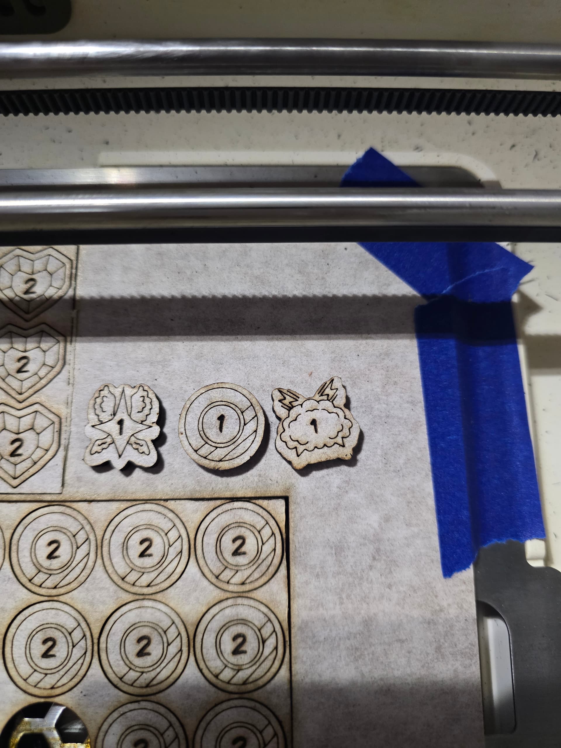

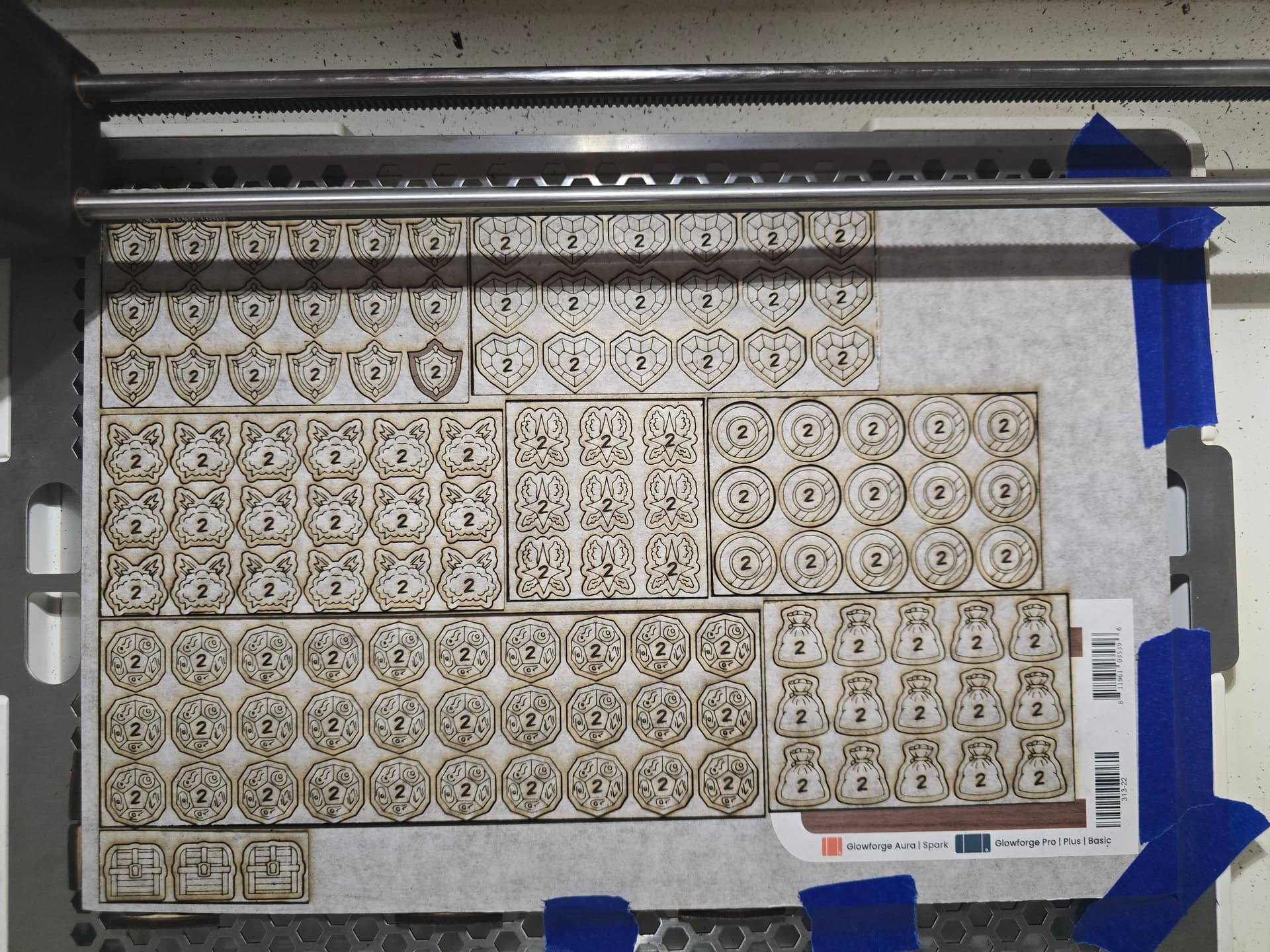

I figured some images might also be useful if anyone else has other tips to add. I engrave and score the 1 side, with a rectangular cut around the tokens. Flip the rectangles and engrave, score, and finally cut the tokens on the 2 side. As you can see, however, the alignment on the 1 side is off. I did not shift material, nor image, but I suspect the image shifted when I went to print as I’ve seen it do a couple of times.
Hmm I’d have to see your artwork to evaluate it. It’s possible that your symmetry is a tiny bit off in the art: to check it flip the image (or in this case each of your arrays of tokens) horizontally. As you flip back and forth any wiggling will be a tell that your alignment is wrong. I’ve had it happen.
Then there’s the matter of kerf. You do have a tiny bit of play when slotting those parts back into their holes, about 0.006”. It sounds very small but it can be noticeable. You can do a trick to help center your material back in their holes, I call it the paper towel trick and explain it in #23 on the faq.
I’m not 100% sure where your alignment accuracy issues are coming from but that’s where I’d start to look.
