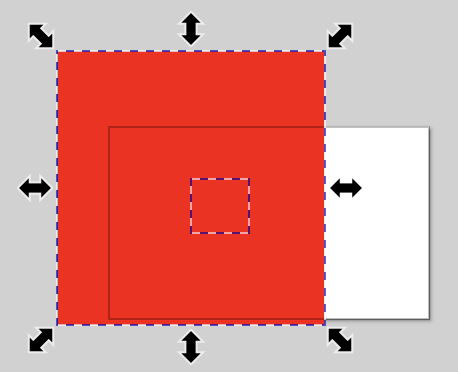

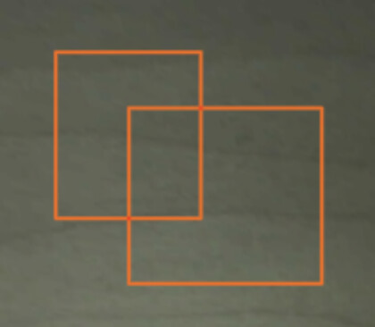

Another thing I should mention regarding stroke - the color makes no difference either. In fact, using different colors is how the design is broken into individual steps in the GF UI.
On the stroke width again - I had Inkscape open so I just created two rectangles, and set one to 1000pt stroke width, the other to 1pt. No fill. In Inkscape:
In GF UI:

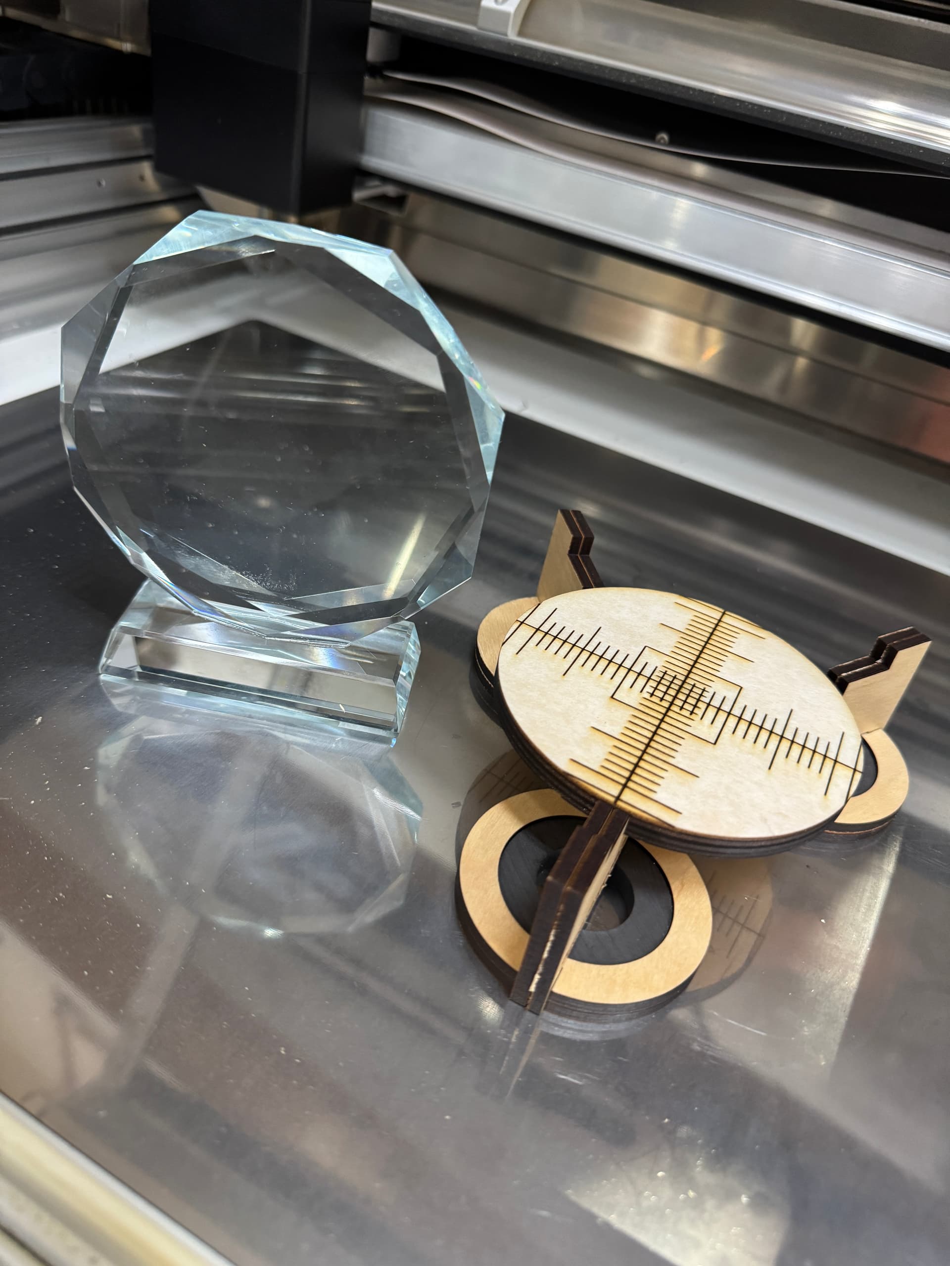

So here’s what I’m trying to do. The goal is to engrave on the flat surface of the crystal award in the middle pic. I already know to drape a wet paper towel over it for the engrave. From another post, full power, 850 speed, 340 LPI was suggested for glass. I’m all ears though on both settings and setup.
You can see what I was trying to do in the other two pics. The round disc with the crosshairs is the same size as the engraving area on the glass piece. I was planning to set it up in my holding jigs (which I now know are too short) and then to practice getting centered on it. I seem to have the least positioning error in the center of my work area. If there are better ways to correctly center a workpiece, jump on in!

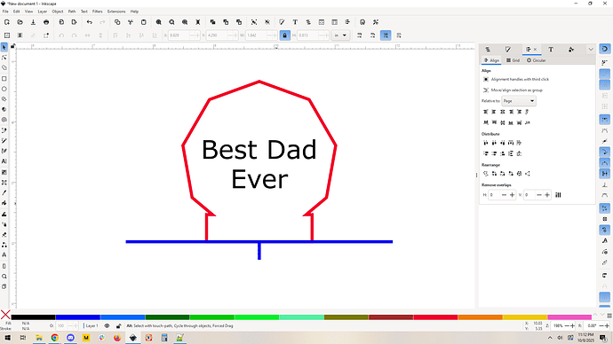

Phase two: Jigging.
In this case, I’d use an edge jig, it’s the simplest way to do an odd shape like this.

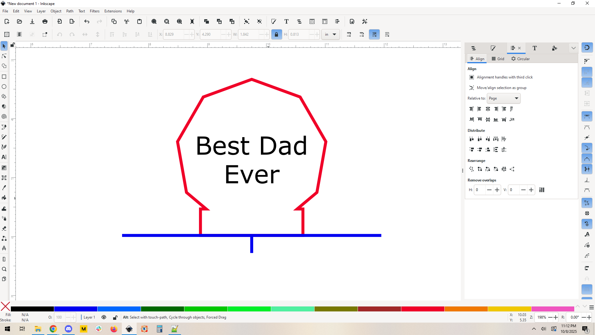

  1. Apply tape across the base of your award. Use your ruler to carefully mark the center of the tape right on the edge with a little line.
  2. Go back to your vector and draw a line across the bottom of your vector outline of your award. This line needs to be a different color from the main outline. This line should be long – too long, you want it to be plenty wide to cut your jig in the next section. Align everything on center to your vector outline.
  3. Draw a short line at 90 degrees to your new and snap it to the center of the line from the previous step. You should have a small “T”, with your small like pointing away from your award outline. This “T” is your jig.
  4. This is basically what you’ll have – engraving in black, outline in red, jig in blue:

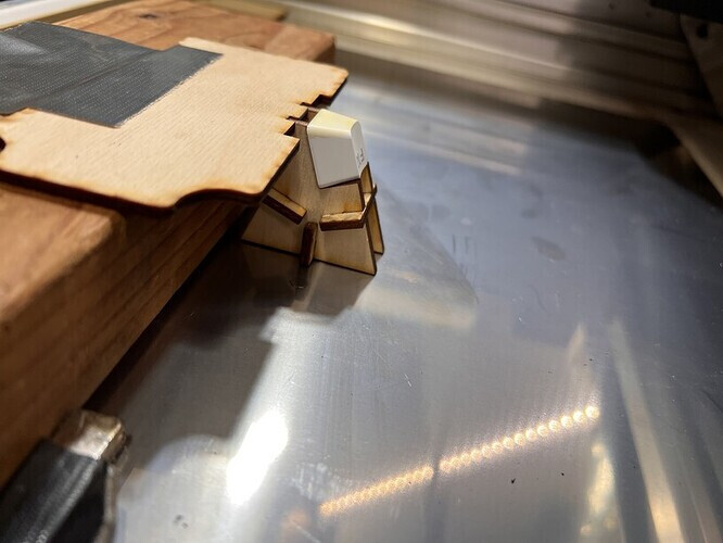

  1. You need the jig material to be high enough so that it hits your award. This doesn’t need to be complex. I like 2x4’s if you can believe it – The tray is about 1.3” tall and 2x4s are 1.5” tall, it works well. I’ll proceed with that.
  2. Take a short length of 2x4 and tape a piece of cardboard to it. You want the cardboard to overhang the edge of the 2x4 by at least an inch, just to make it easy to cut without missing. It doesn’t need to be a huge piece of cardboard here, 3” wide would be plenty.
  3. The jig can’t move once you set it, so find a way to secure it. You can use doublesided tape, but my favorite lately? Hot glue. I just hot glue the 2x4 right to the meta base of the glowforge. Fun hot glue trick: a tiny bit of rubbing alcohol will make hot glue pop right off of a hard surface, so it’s easy to take it out later.
  4. Now you have a “ledge” of cardboard off to the side of your glowforge. Use Set Focus on the cardboard. Import your jig + art into the glowforge UI, and align it to the cardboard so that the jig “T” is in the cardboard. You’re going to cut the edge of that cardboard right off and then the “T” will make a little cut into the cardboard. Remove the offcut. and do not move the jig.
  5. Jig’s done. Here’s an example of this type of jig with an overhang on a 2x4. I used scrap mdf for this one, it uses notches to secure and align my weird keycap holder instead of a true edge jig, and I’m using magnets to hold the 2x4 in place (this was before I thought of hot glue) but the idea is the same:
    It’s not glamorous, but it works.

  1. You’ve got a small problem: your award is clear so set focus will struggle. Luckily you have the center mark tape on the award, unluckily it’s not the same height as the face of the plaque. You’ll need to put an additional small piece of white tape on your award someplace where you won’t be engraving, so you can set focus on that.
  2. Carefully insert your award in the glowforge, on the risers you made.you want to slide it right up to that cardboard and align the small center mark on the award tape to the small “T” cut on the jig, Take your time and get it right, in the end the award should be butted right up against the cardboard, centerline to T mark.

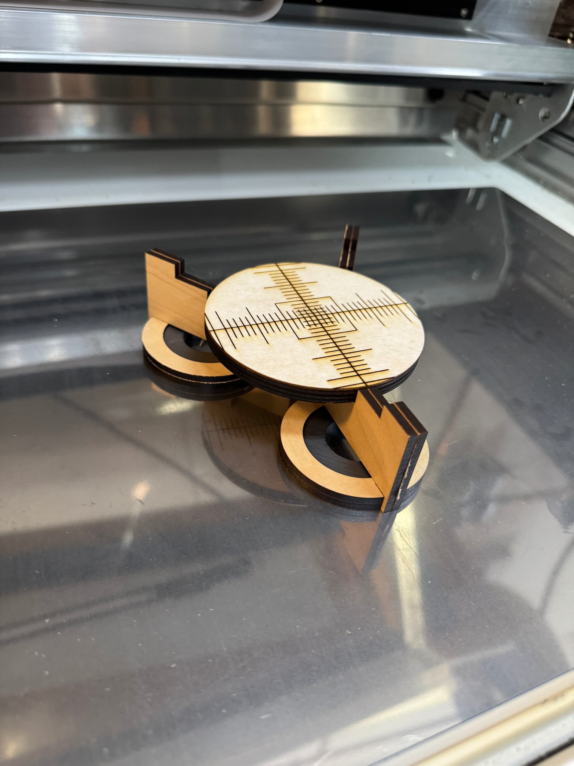

I would just make a jig. A circle the size of the award with my artwork centered in the circle. Cut the circle and ignore the engrave. Put in the award. Focus on the award but IGNORE THE CAMERA VIEW. Ignore the cut and enable the engrave. Because of the thickness of the award, you must make sure the jig material is within focus range.
Edit - never mind, @evansd2 beat me to it and has you covered - especially since I thought the award was two pieces and you just were just dealing with a circle.

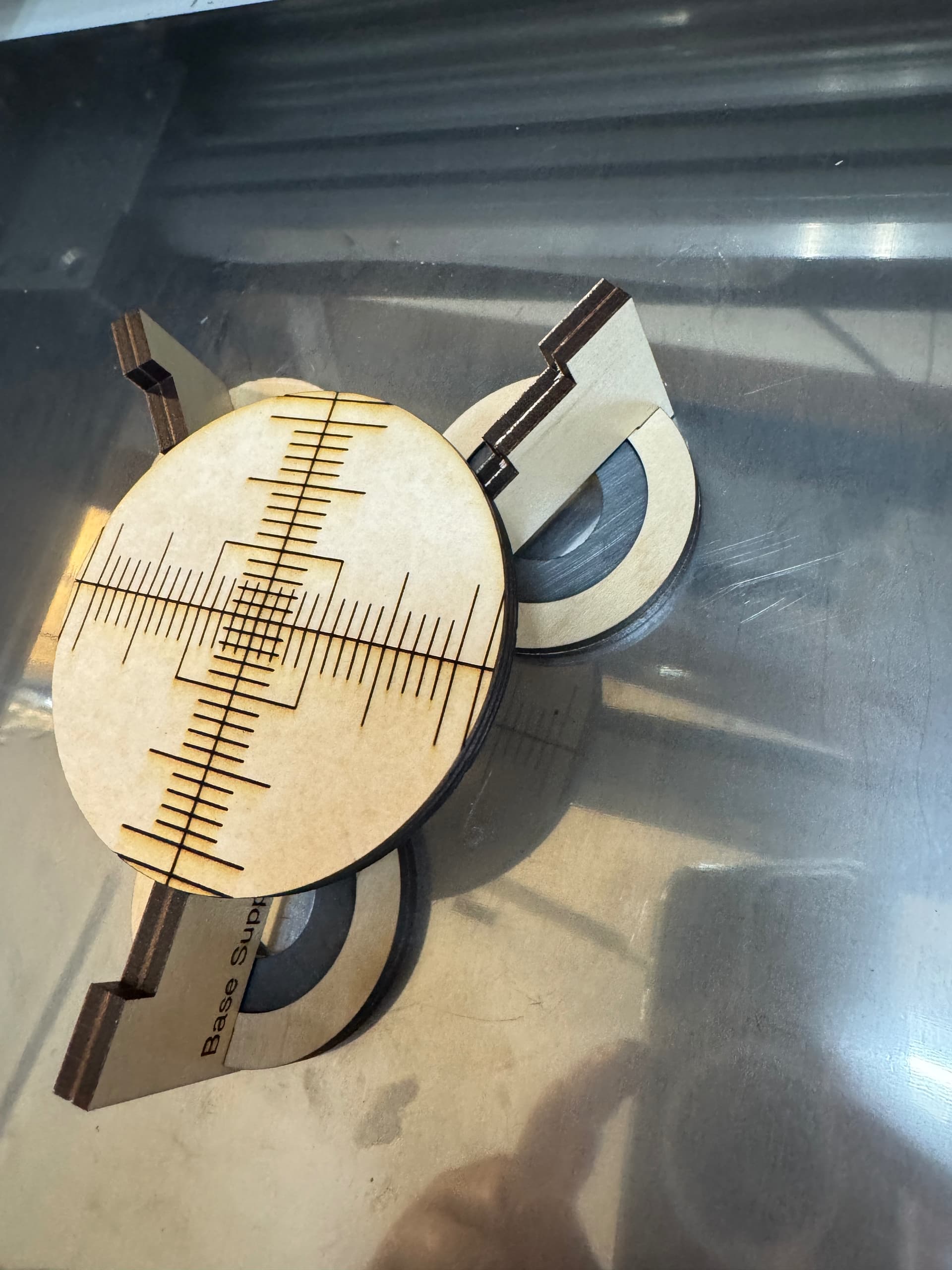

I never use set focus on glass/transparent, and there are other materials where the automated system fails - hence I made this some time ago, and use manual.
In the case of irregular objects where I had the tray removed (shot glasses, spice jars), I would use scraps of material to get the object propped to the desired height, which the little tool can help you determine. Remove the object, take a few measurements, repeat in my design app to build the jig. Then I would cut a piece of shipping box to create a repeatable “locator” that fits squarely against the front corner. I actually always used the right, but most people would say the left would be better.
So my jigs for shot glasses and spice jars are two pieces - and each has an accompanying file with the rough outline of the shape which is set to ignore, used simply for aligning the actual image(s) to be engraved.
