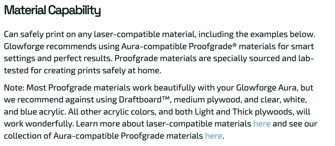

Your Aura power setting is max 10 - that is different than the speed setting which is higher.
Glowforge recommends that 1/8" plywood not be cut in the Aura because of the debris produced by the mdf filling. That being said, many people cut the items from Craft Closet and other vendors on their Aura. If items don’t cut completely, you can adjust your settings. An exacto knife works - as does sanding the back to release the incomplete cut.
I suggest you cut a few simple designs to become acquainted with the interface. Within designs you can assign elements to cut/score/engrave based on the element. The Glowforge interface does not recognize layers per se. Elements are differentiated by color, so use different stroke/fill colors when designing.
Not applicable here; Baltic is wood-core.
Good catch. What Glowforge used to say was that 1/8" plywood was not recommended. Now, however, I believe the recommendation is not to use draftboard. Here is the old statement:
When they listed “plywood” there, i’m sure they meant “proofgrade.”
that said, i could definitely see the Aura struggling with some regular plywood. not because of the mess it makes in the machines (like the PG plywood interior and draftboard), but because it may be more difficult to cut. but i don’t have an aura so i don’t really know for sure.
They state that thick plywood is ok, so I think the filler is the issue.
